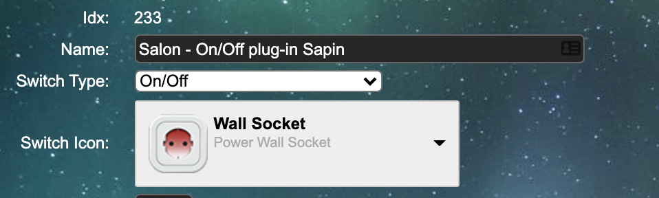

I try to add a block for a plug on my dashboard and this kind of device seem to not be well reconized by Dashticz :
Capture d’écran 2021-12-08 à 02.53.31.png (337.81 KiB) Viewed 524 times

Check 'use_favorites' in CONFIG.js. You probably have to set it to false.

It was exactly my issue, Thanks a lot !
