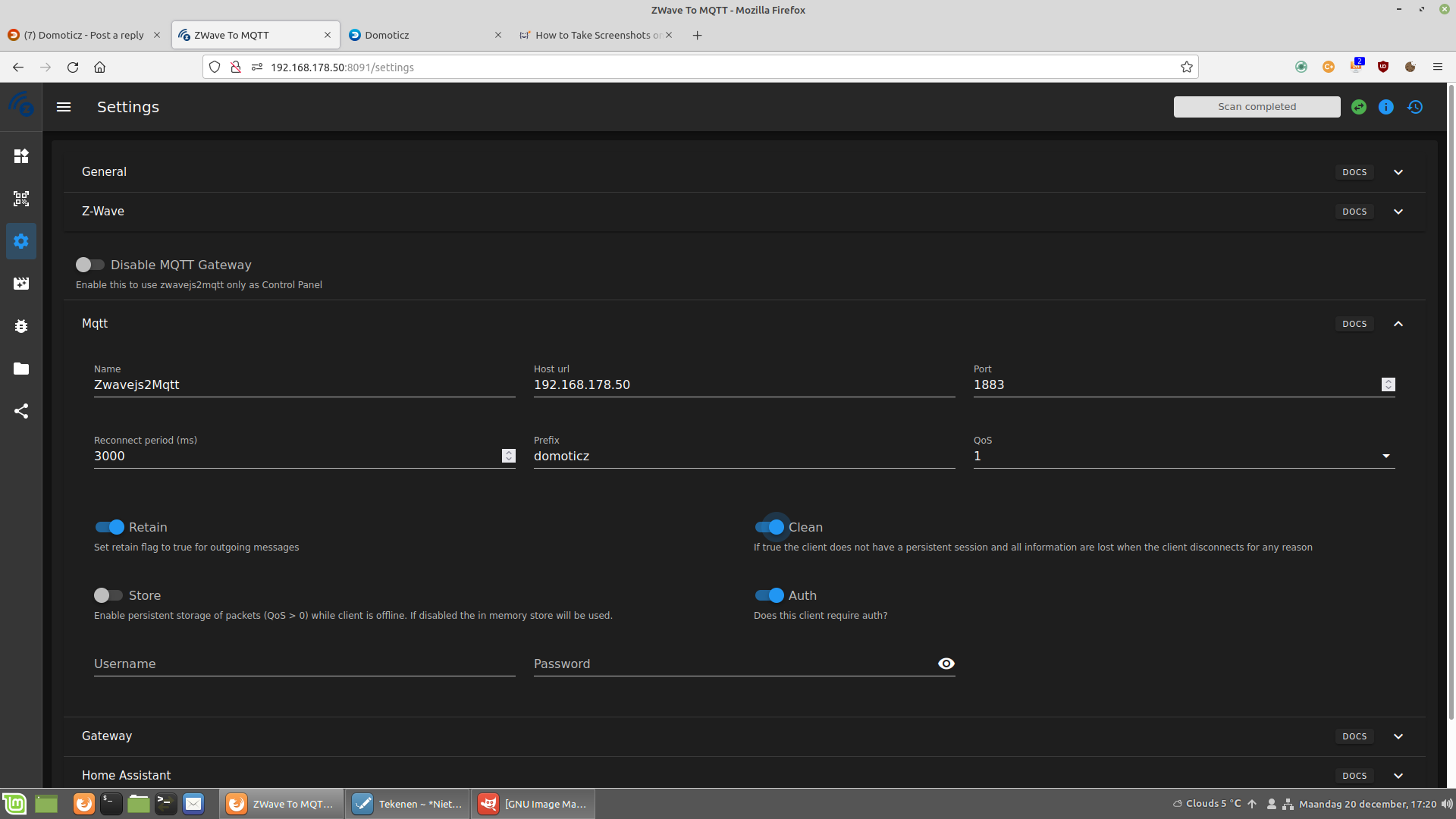

Well I think itś the same. My error looks like this:
 2021-12-20 14:26:09.637 Error: MQTT: MQTT_Discovery: Invalid/Unhandled data received! (Topic: 18/38/0/currentValue, Message: {"time":1640003037730,"value":99,"nodeName":"Wasmachine","nodeLocation":"Zolder"})
2021-12-20 14:26:09.637 Error: MQTT: MQTT_Discovery: Something other then 'config' received on discovery topic! (23/38/1/currentValue/{"time":1639954365610,"value":0,"nodeName":"Kamer dimmer","nodeLocation":"Huiskamer"})!
2021-12-20 14:26:09.637 Error: MQTT: MQTT_Discovery: Invalid/Unhandled data received! (Topic: 23/38/1/currentValue, Message: {"time":1639954365610,"value":0,"nodeName":"Kamer dimmer","nodeLocation":"Huiskamer"})
2021-12-20 14:26:09.738 Error: MQTT: MQTT_Discovery: Something other then 'config' received on discovery topic! (23/38/2/currentValue/{"time":1639821438142,"value":99,"nodeName":"Kamer dimmer","nodeLocation":"Huiskamer"})!
2021-12-20 14:26:09.738 Error: MQTT: MQTT_Discovery: Invalid/Unhandled data received! (Topic: 23/38/2/currentValue, Message: {"time":1639821438142,"value":99,"nodeName":"Kamer dimmer","nodeLocation":"Huiskamer"})
jvdz wrote: Monday 20 December 2021 15:34

rron wrote: Monday 20 December 2021 15:41 Well I think itś the same. My error looks like this:
No this looks different. You are getting updates for discovered devices that cause an error.
Can you share the CONFIG MQTT message for these devices so I can check?
Also: What is your MQTT discovery topic in Domoticz?
You have to help me out, just started this. You are meaning this?

jvdz
Posts: 2482
Domoticz version: 4.107
Re: MQTT Audo-discovery
Post by jvdz »
You need to set the prefix the same at both sides, so change the domoticz prefix in ZWAVEJS2MQTT to homeassistant as well when that is what you have defined in domoticz/mqtt.
That topic prefix is used to exchange the device CONFIG topics & payload for auto discovery!
