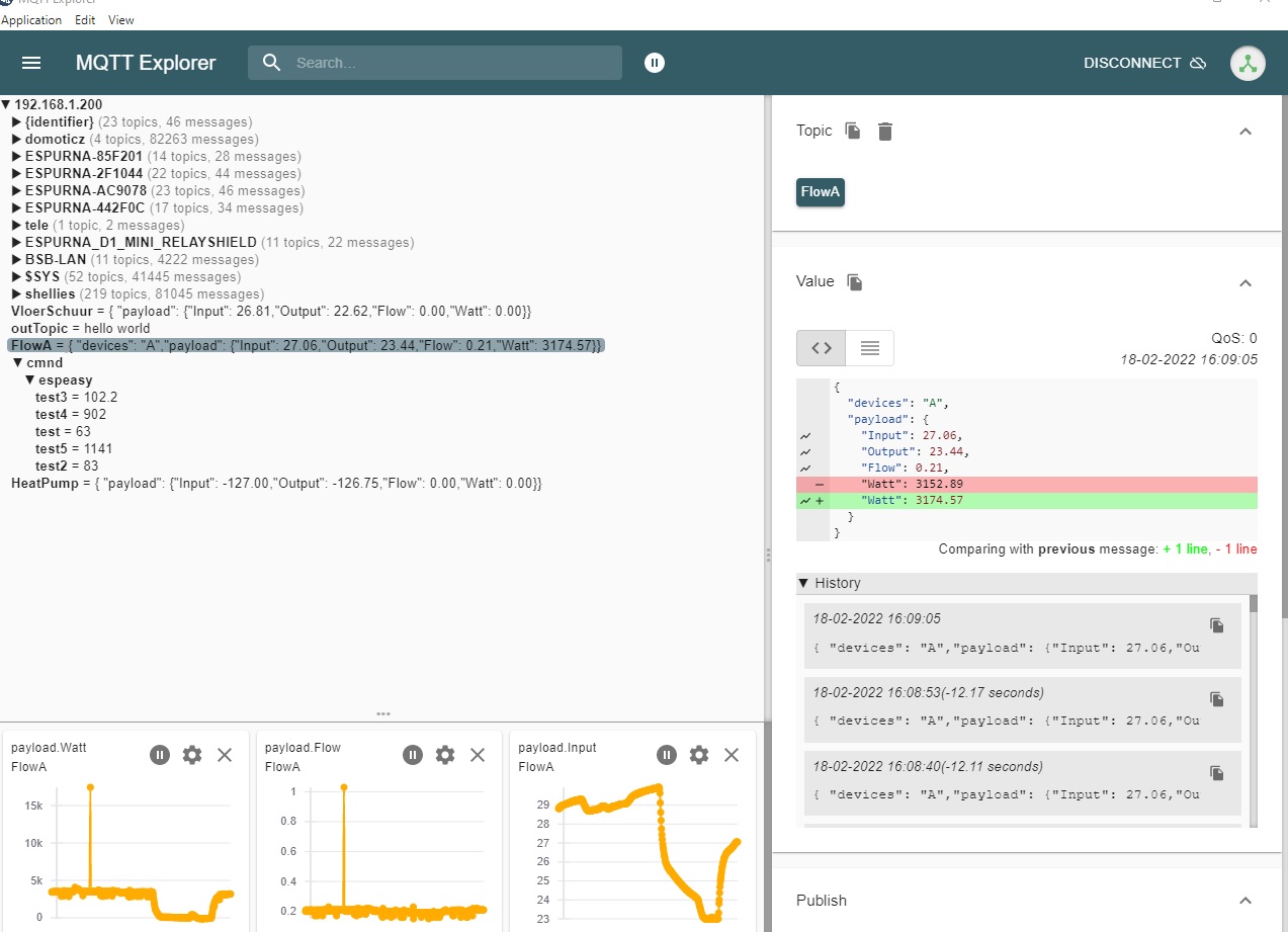

can someone help me to import data from Mqtt to Domoticz.
I want to import data to a specific IDX.
I made a screenshot of MQTT Explorer, but can't figure out how to import these values.
so:
Input to an IDX
Output to an IDX
Flow to an IDX
Watt to an IDX
I want to do it with a Node-RED sequence (flow)
any help would be appreciate
Thanks, Peter
Screenshot MQTT Explorer
import data.jpg (193.76 KiB) Viewed 3888 times
Posts: 7039
Domoticz version: 2026.3
Re: [90] MQTT Support
smitex wrote: Friday 18 February 2022 16:16 Hello,
Thanks, Peter
You better create a new topic in the Node-red sub topic to get better help viewforum.php?f=81

Hello @smitex,
I do not understand, why you raise this issue again at this forum this afternoon.
It has been answered yesterday.Do not post the same issue at multiple forums.
See: https://discourse.nodered.org/t/mqtt-da ... -idx/58476
smitex
Joined: Thursday 31 December 2020 18:09
Post by smitex »
Oh, sorry FireWizard,
I did not jet see you post, thank you very much for you repley,
I will test you nodered flow👍👌
