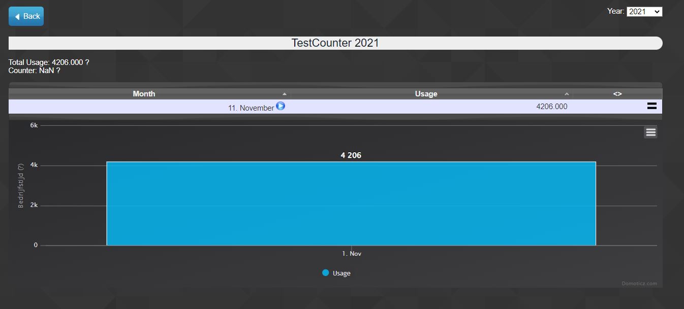

I have a bug which I am unable to fix in domoticz.
In the virtual sensor department I have created a standard counter.
Under the report functionality it is showing NaN and a question mark instead of the units.
I have tried to update the counter using DsVents and Lua, but in both options the result is the same.
The log functionality itself is operating without any troubles.

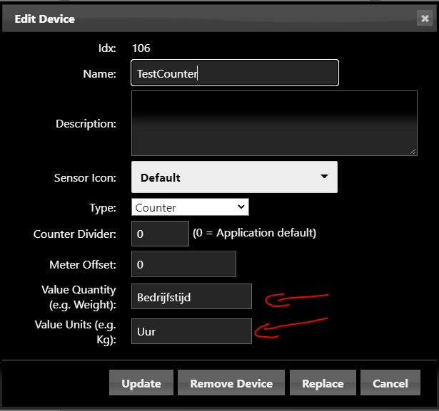

Make a screenshot of your device when clicked on Edit button.
You have to fill in something with Value Units, eg "hours".
https://www.domoticz.com/wiki/Dummy_for ... es#Counter

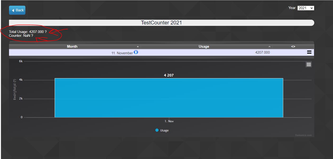

Hi Waltervl,

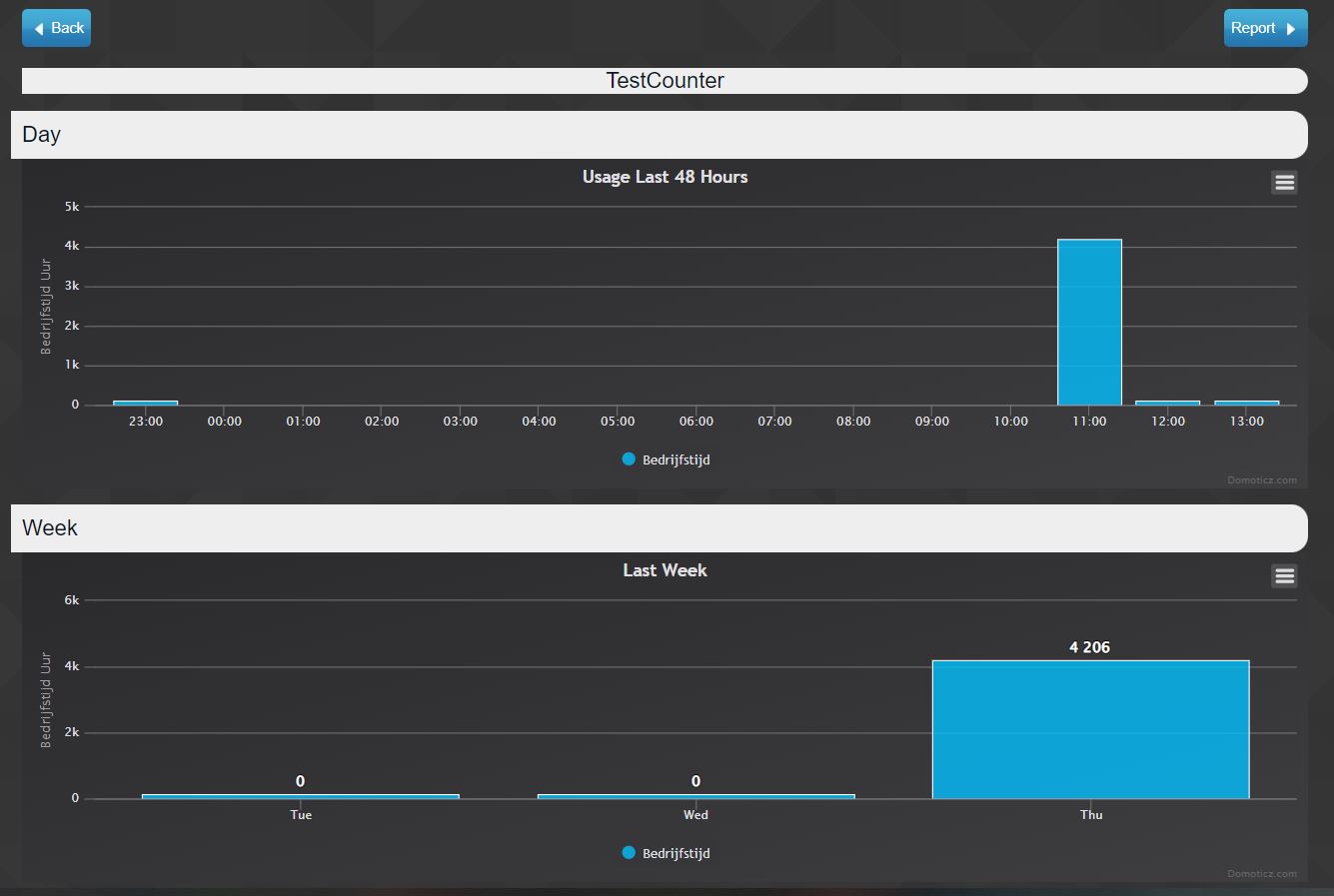

The counter itself is working fine. Under the log functionality you can see them updating every hour/day etc etc. No problem at all.
The problem is visible when you press the report button and see monthly/yearly values. Then the counter value suddenly has 3 decimals, NaN (Not a number) values, and a ? (Question mark), instead of the units you have defined in the edit menu.
It seems not to recognise the total counter value, cause total usage is yearly summed up.

Yes, I can reproduce that behavior on my test system.
The question marks also show up on when setting the counter to energy, gas or water. So its seems a bug.
