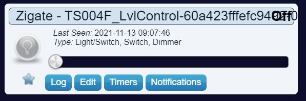

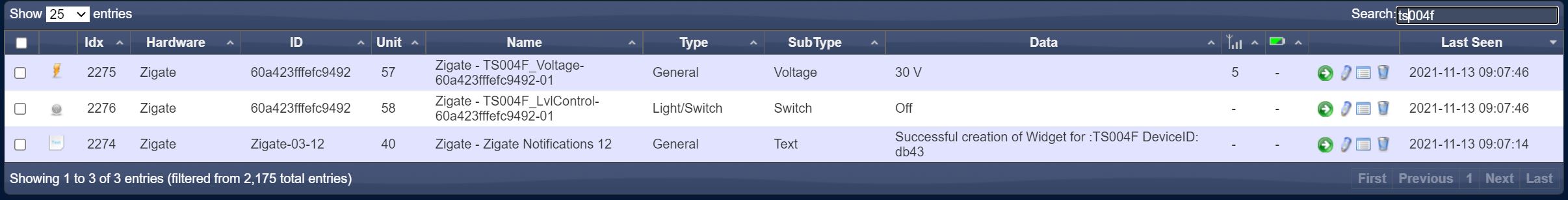

Device shows up as a voltage and a dimmer switch and no button presses are shown in the log or update the switch.
I tried changing the switch type to selector switch within Domoticz - but as expected this didn't improve the situation

Great progress with new beta of Zigate plugin.
The device now appears in Domoticz as four selector switches each with click/double-click/long-click options
However only one button (the top left) registers anything in Domoticz.
This button only works after I put the switch into 'scene switch' mode by holding both the top & bottom right hand keys until the bottom left hand light flashes on.

Pressing the other three buttons does not produce any entry in the Domoticz log

I did a log of the 'enable debug input' (and the others recommended in the plugin wiki)
There only appears to be log activity when the top-left button is pressed (single, double or long press).

Upgraded to latest beta 5.5.290 and restarted domotiz
I removed all four of the selector switches from Domoticz and then re-paired.
Same behaviour as before.
Only the top-left button does anything.
Nothing in the domoticz or plugin log when I press the other buttons.
It would seem the device isn't initialising correctly.
