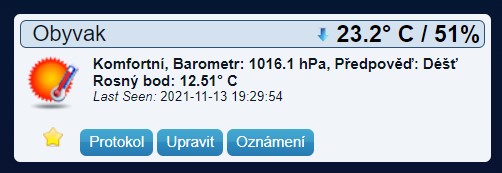

In dashticz I can see a trend :
Snímek obrazovky 2021-11-13 193332.jpg (26.83 KiB) Viewed 370 times
also in json so is any way how to get a simple arrow with a trend?

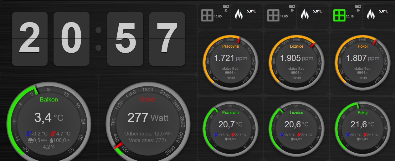

HI, is just three possible arrows. Up, down and nothing or same :)
The information came from Domoticz, so my idea is just a small arrow up or down.
Snímek obrazovky 2021-11-13 205236.jpg (90.58 KiB) Viewed 363 times

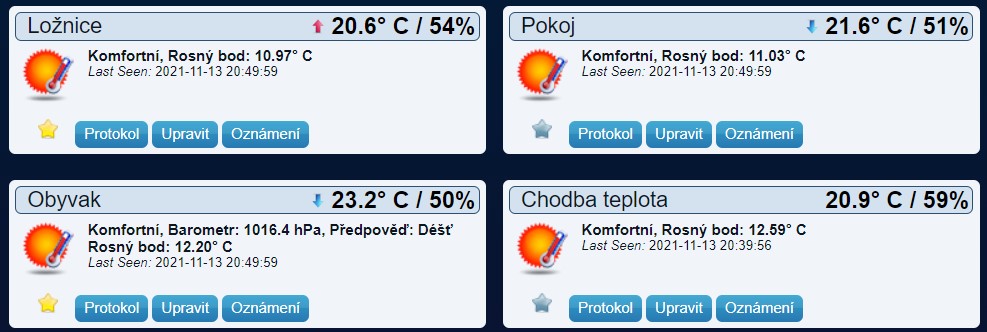

Currently, I have a min and max temp in every room, so the best for me will be a small arrow same as I have for min and max temp.
Snímek obrazovky 2021-11-13 205724.jpg (127.6 KiB) Viewed 363 times
