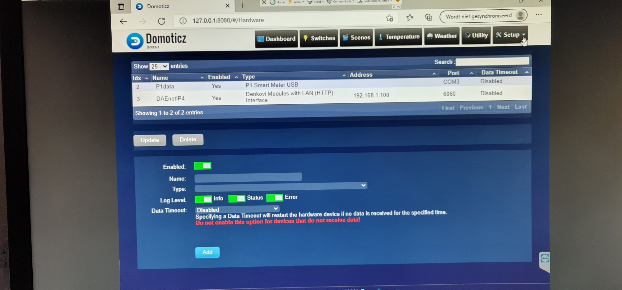

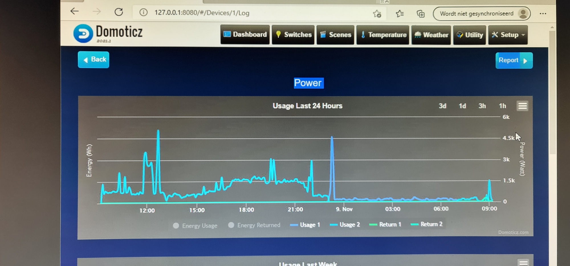

I install the newest Domoticz stable version
And i configure my hardware on my new PC
P1 smart meter USB
Denkovi module with lan see also viewtopic.php?f=59&t=28145&p=215814#p215814
I can see in my devices that the hardware works

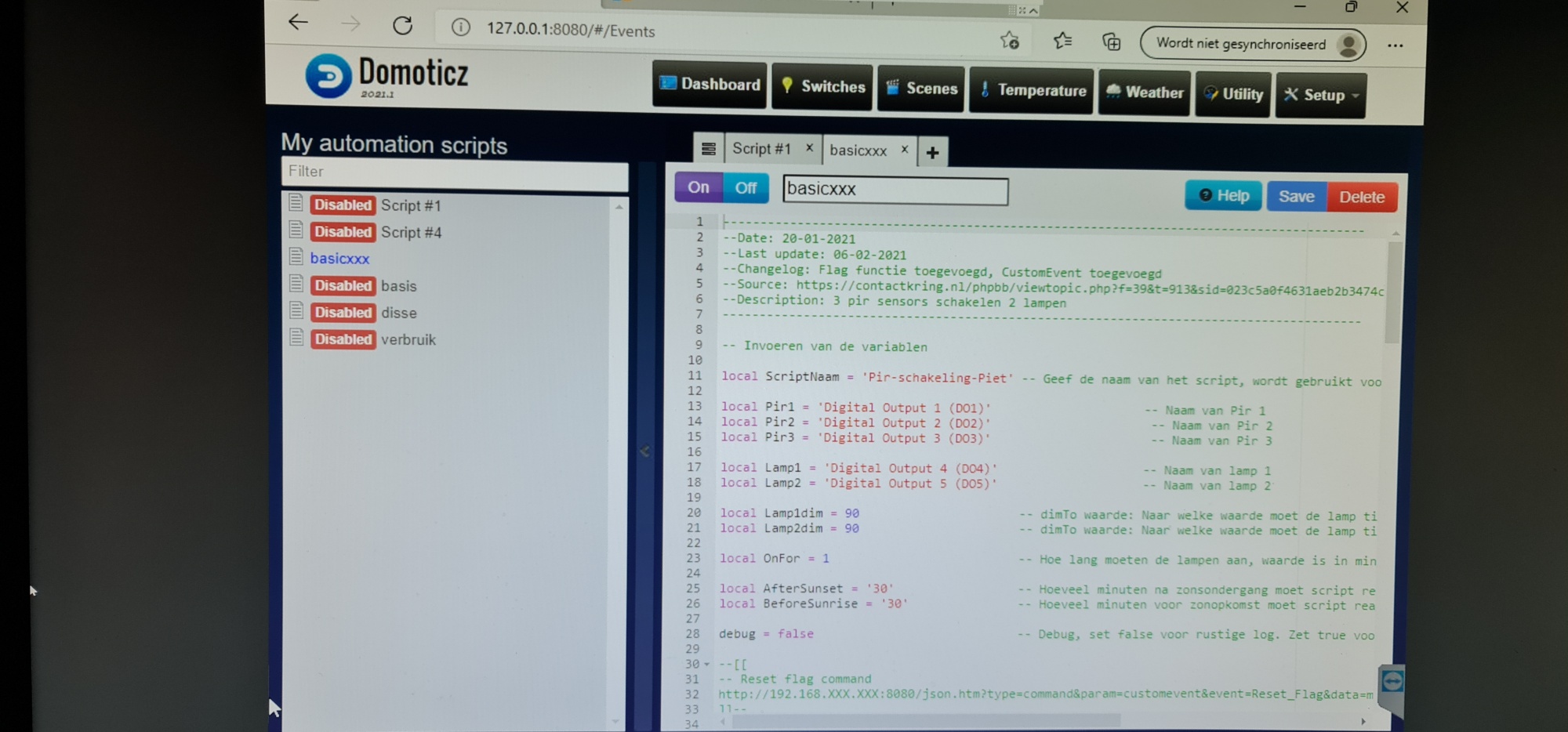

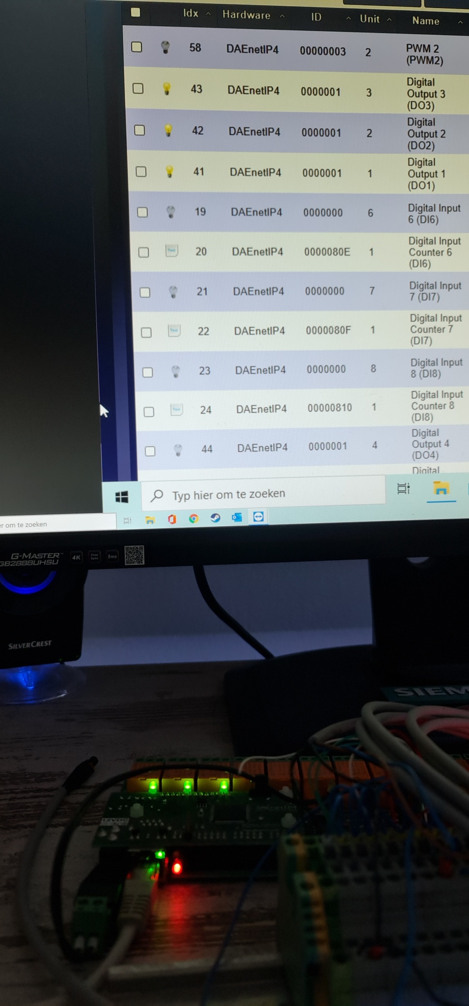

And also my Denkovi I can read out and click on of my outputs, in devices
But when i made a dzvents program i get a error
I enables al in
setup/setting/other eventsystem (lua/blocky/scipts)
setup/setting/other dzventz
I enables al in

When i made a program, or my other stable program thats works on my old synology.
I get a error
I try many programs but every time i get a error

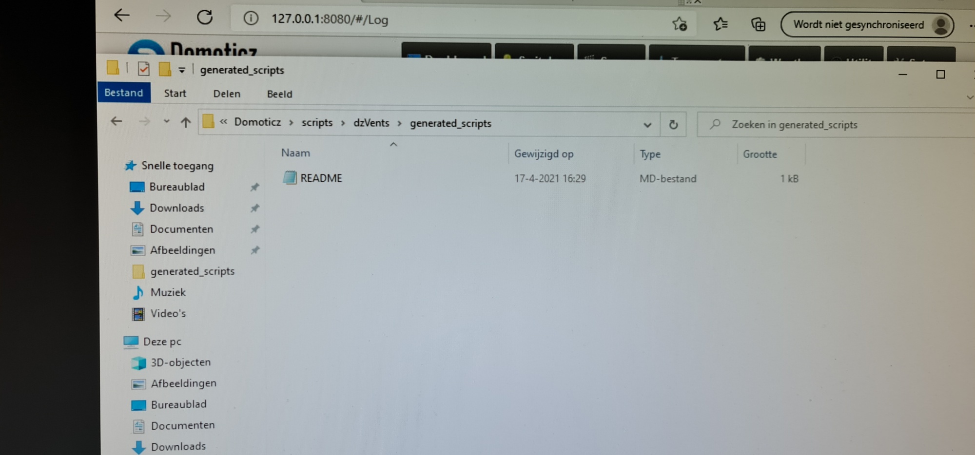

2021-11-09 09:15:49.152 Error: EventSystem: problem writing file: C:\Program Files (x86)\Domoticz\scripts\dzVents\generated_scripts\basicxxx.lua
When i look in the map there is no program ?
But when i look in Domoticz setup / more options / events the program is there .
Who can help me, i don't now any more
I get a error

check what rights the user running domoticz has on directory
since this under C:\Program Files (x86) i suspect it is read only.
this needs to be writable.

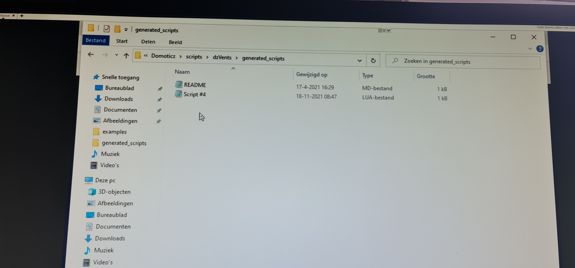

Re: dzvents problems after new installation (solved)

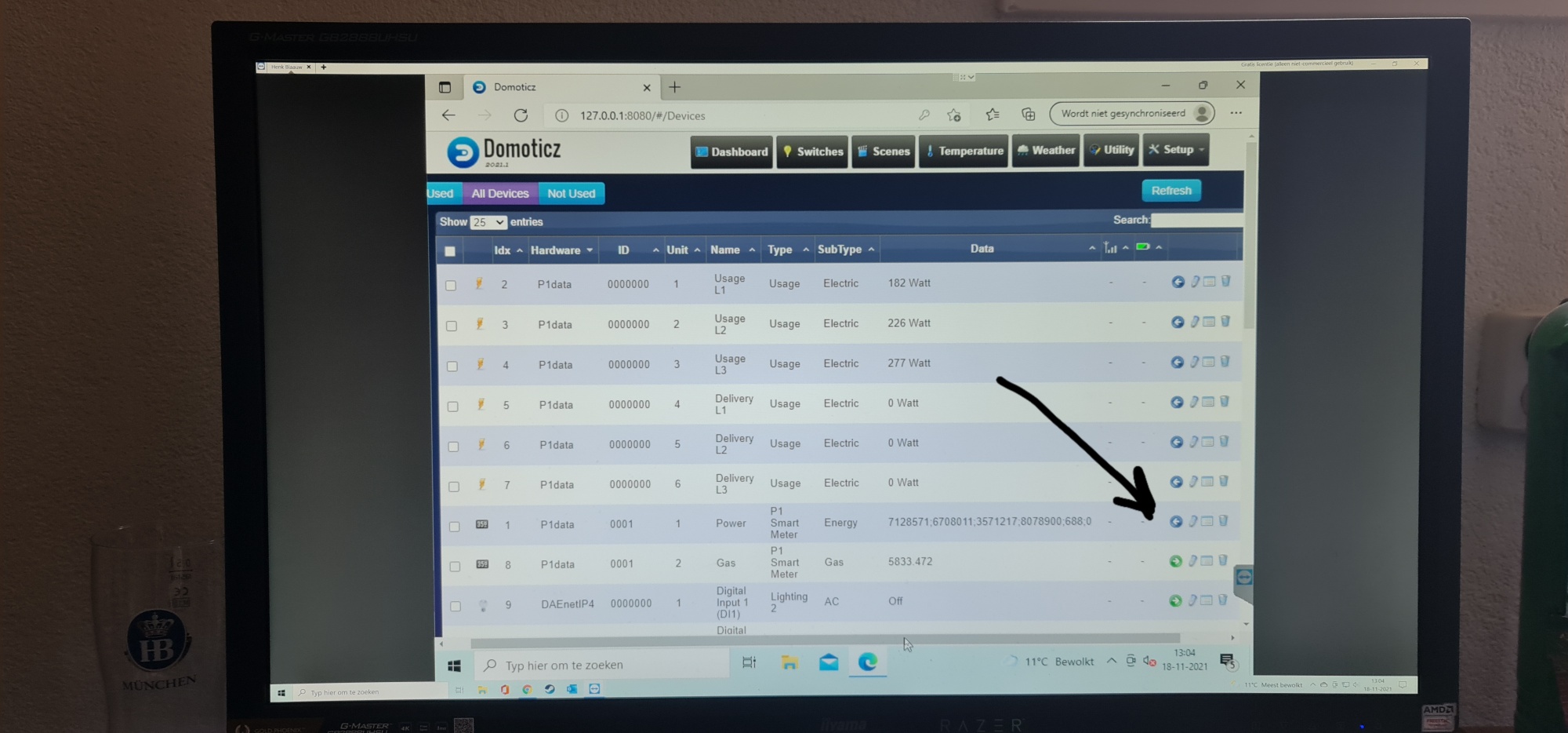

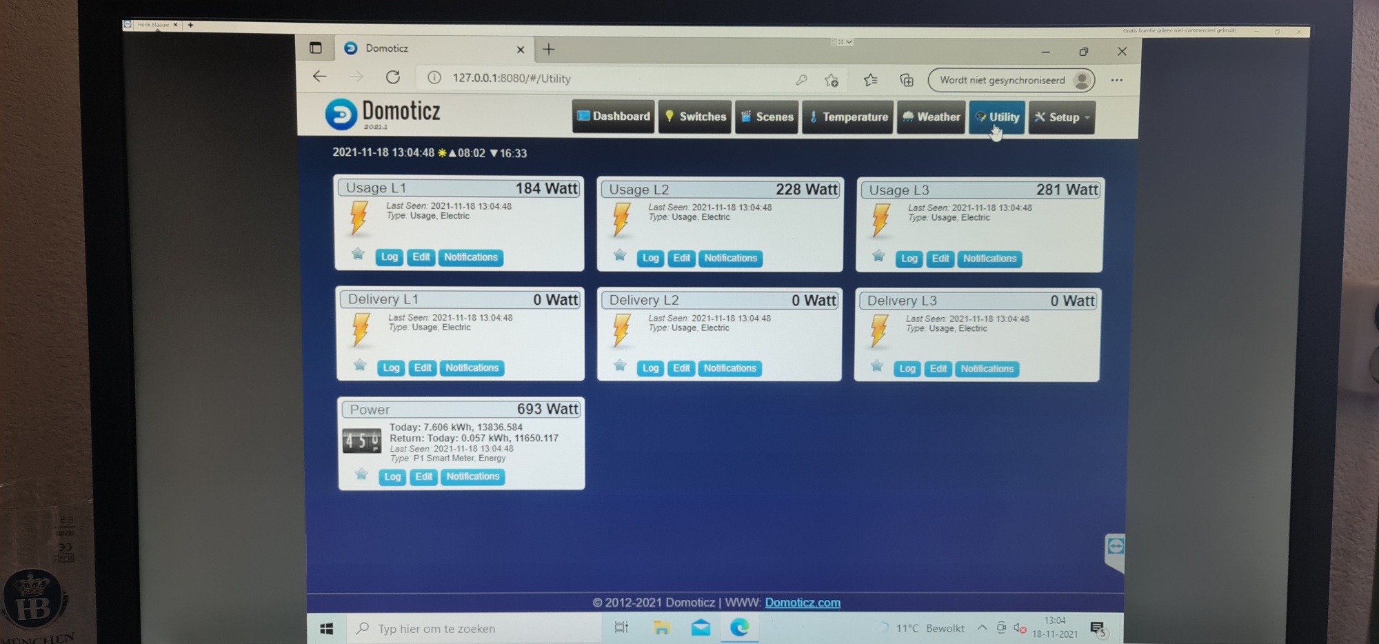

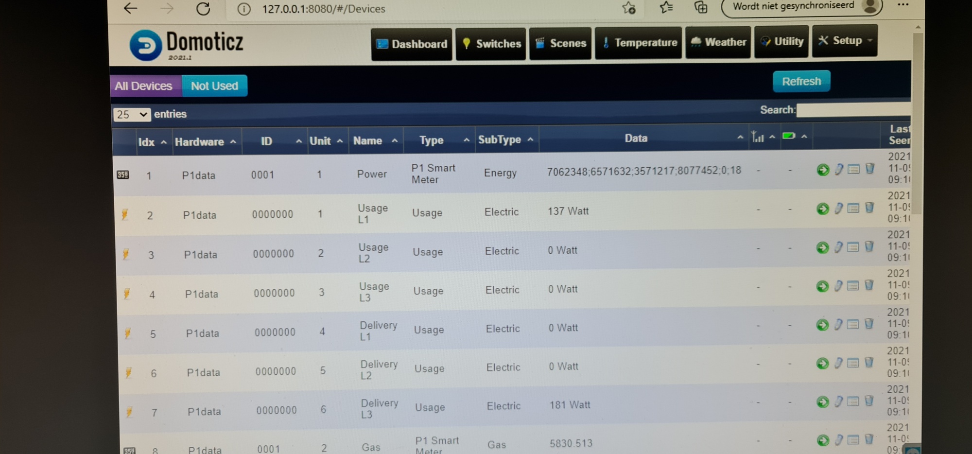

I was forgotten to "add" the devices
(blue green arrow in Devices)
Now i see them in Utility's
When i did that everything was oke, and the script was placed in the map
