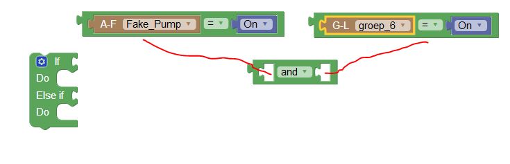

This isn't working
I use one on switch . if the night lock is off turn on. And if the night lock is on turn off for 1 minute
Can someone help me
Gerwin
See exampleImage

Take a good look at the many examples here: https://www.domoticz.com/wiki/Blockly
Create the combinations like
(Nacht slot = Off) and (Remote control = On).
Start with "and" block
Add a left block: (Nacht slot = Off)
Add a right block: (Remote control = On)
Do the same for the Else if

Build it like this:
Check via the blue button "Show current states" if On/Off is correct (or Open/Closed?)
