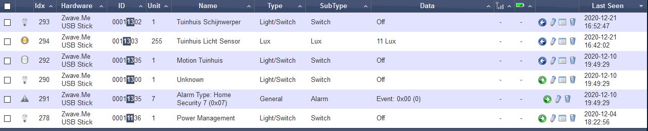

I assume you'd enabled "Accept new Hardware Devices" in the settings? I recently added the same hardware and after including it provided the following devices:

You could try power off/on the sensor first after enabling "Accept new Hardware Devices" before trying exclude/include.
I use the default group 1 (lifeline) assignment and "Normal mode with lifeline error signalisation" slave mode .
Btw. the device with Idx 278 (power management) is not associated with the Steinel sensor!

After reincluding the sensor.... still nothing... And then, while writing this message and double checking... new Devices show up... :D
XXXXX00 Sensor - ???
XXXXX01 Switch - Allows override of lights AND shows actual status when switched by sensor
XXXXX02 Switch - Allows override of lights only
XXXX03 Illumination - Lux measurement
XXXXX35 Home Security - Motion detection switch
XXXXX37 System - ???
XXXXX35 (Unit 7) Alarm Type: Home Security
No idea what device 00, 35 (Unit 7) or 37 are... I'll ignore them for now...
