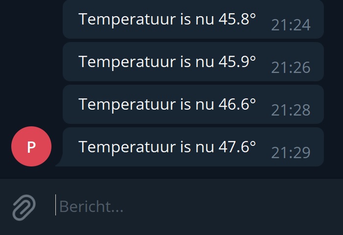

So far so good, all seems to work now :D
devices = {
199, 43
timer = {
'every 2 minutes'
logging = {
level = domoticz.LOG_INFO,
marker = "Sauna"
execute = function(domoticz, devices)
local Home = domoticz.devices(199)
local Sauna = domoticz.devices(43)
local Temp = tostring(domoticz.utils.round(domoticz.devices(42).temperature, 1))
if Sauna.state ~= 'On' and Home.state == 'On' then
Sauna.switchOff().afterSec(900)
if Sauna.state == 'On' then
domoticz.notify("Sauna","Temperatuur is nu "..Temp.."°",domoticz.PRIORITY_HIGH, "telegram")
Only thing still need to figure out is how to only message to telegram, now the message is send to both..
