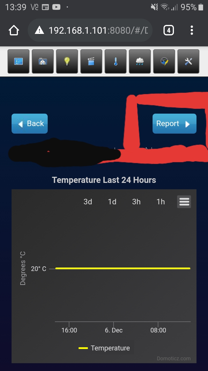

Hi, I have a question again, the script works great, but I can not see the data from the previous year or it is not saved at all, how can I make it look at the data (report link in other sensors)
data from http://waqi.info/
An API key is required and can be aquired here ==> http://aqicn.org/data-platform/token/
Based on the original idea and script from @elmortero
http://api.waqi.info/feed/geo:51.852062;4.507676/?token=Your_apikey = Zwartewaalstraat, Rotterdam Zuid
http://api.waqi.info/feed/geo:51.986119;4.934413/?token=Your_apikey = Lopik (co)
http://api.waqi.info/feed/geo:51.867238,4.354981/?token=Your_apikey = Leemkuil (so2)

mojso wrote: Sunday 06 December 2020 13:35 Hi, I have a question again, the script works great, but I can not see the data from the previous year or it is not saved at all, how can I make it look at the data (report link in other sensors)
That functionality is not implemented for custom sensors. Data is available in database in table multimeter_calendar but if you need a multiyear report you will have to export the data from the database to something like excel.

mojso
Posts: 92
Joined: Friday 08 November 2019 23:07
Re: Get online airquality data
Post by mojso »
thanks Waaren for the reply. I do not want to export the data for now, just have a preview in domoticz (Report link) thanks in advance
mojso wrote: Sunday 06 December 2020 14:24 thanks Waaren for the reply. I do not want to export the data for now, just have a preview in domoticz (Report link) thanks in advance
I don't think it will be implemented for custom sensors any time soon; if at all.
mojso
Posts: 92
Post by mojso »
waaren wrote: Sunday 06 December 2020 15:07
thanks for the info
