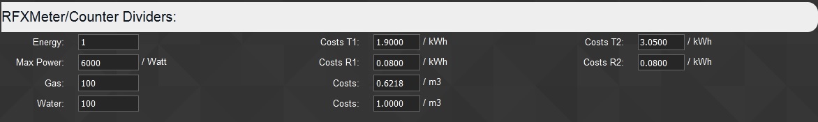

There was a desire to adjust the tariff in automatic mode. The electricity supplier has a website that publishes current tariff prices. I can read them from the site, but I want to write them to "Costs T1" and "Costs T2" in the "Meters / Counters" tab of the settings through the dzVents script. Is it possible to do this without having to edit the Domoticz database?

I apologize, but the question is not who has what tariffs, but how to save the data received from the site into the system variables CostEnergy and CostEnergyT2
