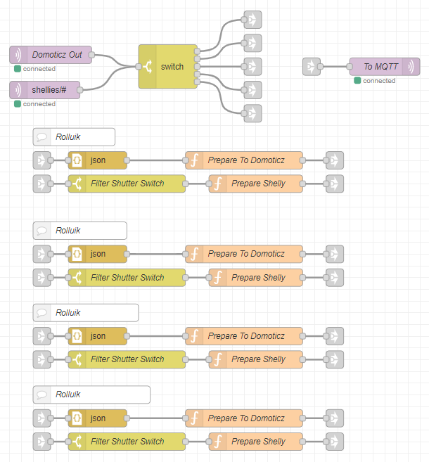

hoeby
Posts: 531
Joined: Saturday 02 June 2018 11:05
Domoticz version: V2022.1
Location: Echt, Netherlands
Re: Python Plugin: Shelly MQTT
Post by hoeby »
CronoS wrote: Tuesday 07 December 2021 20:45 So for me, ongoing development on the plugin is important because of this.
For me this is the reason to not use plugins, because then you will be dependent on the developers of this plugin.
For this reason, i use nodered and make flows. When i started with it, i thoughed is this the best way. Now i think, yes it is.
When you have the flows and information. Then it will be getting easier and easier to extend the flow.
By doing this, you will not be dependent on the plugin, you have controll in your own hands.
I don't have much shelly devices, but more zigbee devices.
In the past i used zigbee2mqtt, but also this i stopped and transfered to sonoff tasmota zigbee.
For zigbee i will be dependent from the firmware for the zigbee coordinator. But i will try to keep this to a minimum.
This is a small flow i use for the shelly 2.5. To give you an idea
