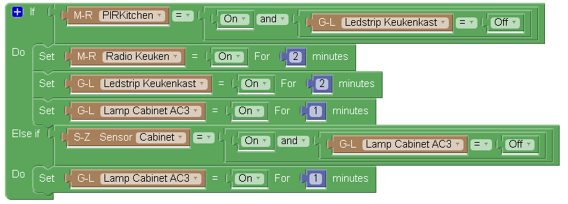

I can't get this Blocky to work. The radio doesn't play but the lights do turn on. Can someone point me into the right direction?

Heisenberg wrote:I can't get this Blocky to work. The radio doesn't play but the lights do turn on. Can someone point me into the right direction?
Radio should work, just like the lights. But you should also include a check if the device is off. Otherwise Domoticz will keep sending the 'on' command to the Radio and LED kitchen light as long as the PIR is on.
Make it like this:
IF PIRKitchen = On AND LED Kitchen Light = Off
DO SET LED Kitchen Light = On FOR 2 Minutes
ELSE IF Sensor cabinet = Open AND LED Cabinet = Off
DO SET LED Cabinet On FOR 1 minutes
This decreases CPU load and also pollution on the 433Mhz band (otherwise Domoticz will keep sending the 'On' commands like i said).

Make it like this:
Hi, thanks for the tip! I changed it and now the Radio and Kitchen Light do turn on but the LAMP Cabinet doesn't :(
I don't understand why. Also I change the name of some sensors. I don't think that's an issue.
EDIT: I got it working again with this Blocky.
