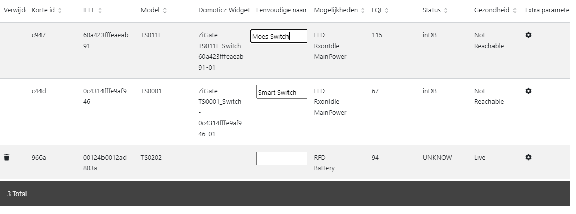

I have a Zigbee 3.0 motion sensor from Aliexpress (https://nl.aliexpress.com/item/1005002419717912.html). My ZiGate+ does receive signals and also creates device in the plugin (see image, bottom item). But there is no device successfully added in Domoticz. I do see a number of attempts but it finaly cancels with an error. From the plugin I exported the "unknown devices" json, it is in the zip file attached. Anyone able to get this PIR sensor working?

This device is not yet supported on the plugin, you are the first one trying it.
I just did some changed in the beta branch, so it would be good to test
- stop Domoticz or the plugin
- go to the ZiGate plugin home directory
- git pull
- git checkout beta
- git pull
/* this will bring you to the beta branch
- restart the plugin
- Start pairing the PIR

Yep, that does the job. It is now recognised as Motion detector. Thanks again!
