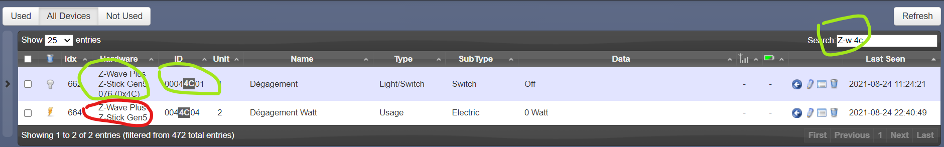

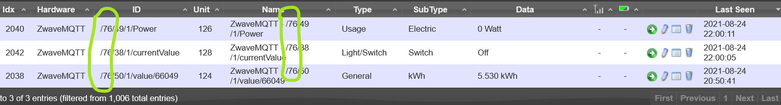

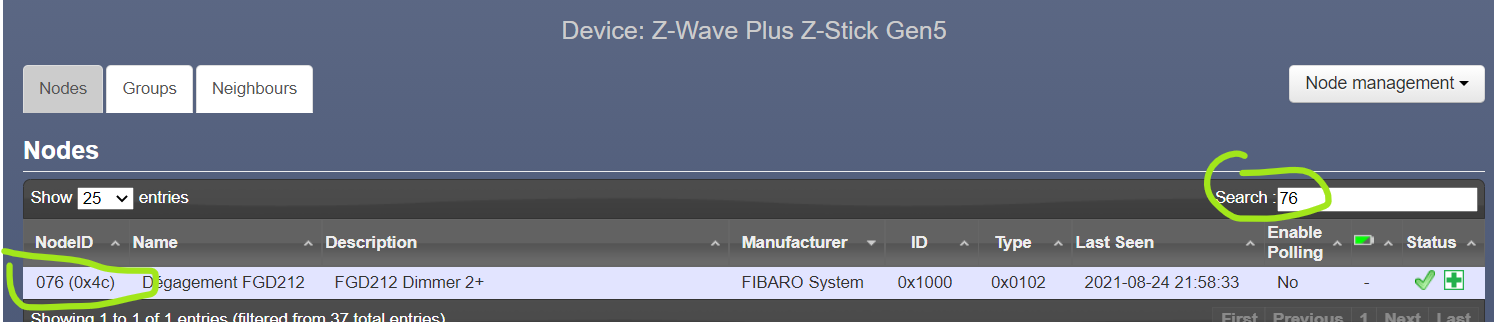

heggink wrote: Tuesday 24 August 2021 21:45 btw: you can see the node number from the devices tab in domoticz. It's the number after the first / in the device id or name. so /76/xxx is node 76. You can see that in OZW as well as in zwavejs2mqtt.
Ok, so I've got this
with zwavejs2mqtt
Screenshot 2021-08-24 223200.png (55.67 KiB) Viewed 4161 times
with openzwave
Screenshot 2021-08-24 223335.png (60.51 KiB) Viewed 4161 times
Screenshot 2021-08-24 224148.png (81.22 KiB) Viewed 4161 times
I don't have always the id in the Hardware (Device tab)
So the job will be to rename all the devices and add them in the right plans and the scripts with the new id.
Perhaps a script to write
