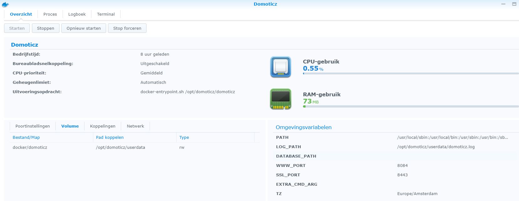

regarding people have write errors or problems with save settings
you have opt/domoticz/userdata mapped to docker/domoticz(this is a directory on your synology)
make sure you have or create these directories

- Tab 'Volume' -> 'add folder' and select (or create and select) 'docker/domoticz', then 'connect path' -> /opt/domoticz/userdata
what you are doing here is map internal directory of the docker container(/opt/domoticz/userdata) to an external Read/write directory on your synology /volume1/docker/domoticz
so the docker container thinks it is writing to userdata but it actually writes to an external directory on your synology.

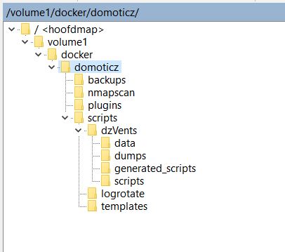

Re: Synology - guide to switch from Jadahl package to official docker (domoticz-docker)
Post by Gravityz »
@Platte73
what domoticz version are you using.
can you post a screenshot of your setup like the one i am posting now. if paths are correctly mounted you should not have write errors
from synology docker user interface
if mountpoints are missing please create
from winscp directory view
if directories are missing please create
the rights should be root root
domoticz directories.JPG (26.4 KiB) Viewed 2503 times

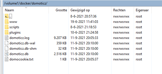

Platte73
Posts: 16
Joined: Thursday 28 January 2021 19:23
Post by Platte73 »
Here the screenshots of my synology settings and the winscp

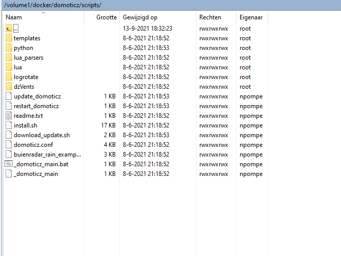

Post by Platte73 »
Here a screenshot of my scripts folder.
I also created the backups folder. Can you tell me how and where to activate the automatic backup
Post by Gravityz »
automatic backups are enabled from domoticz-settings-system.(but first create the directories below)
please note that write errors are most of the times caused because domoticz can not find an existing directory.
so please look at my directory structure and compare it with yours.
please open the complete directory structure like i did
you need to have these directories on your synology
volume1/docker/domoticz/backups
volume1/docker/domoticz/scripts
volume1/docker/domoticz/scripts/dzvents
volume1/docker/domoticz/scripts/logrotate
volume1/docker/domoticz/scripts/templates (this directory has to include the templates from container /opt/domoticz/scripts/templates)
volume1/docker/domoticz/scripts/dzvents/data
volume1/docker/domoticz/scripts/dzvents/dumps
volume1/docker/domoticz/scripts/dzvents/generated_scripts
volume1/docker/domoticz/scripts/dzvents/scripts

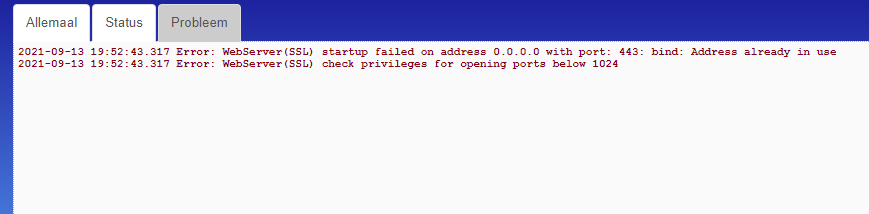

I have all the same dir's as you have. But in my domoticz log I also have an error. Can this be the problem for the saving settings
Gravityz
Posts: 652
Domoticz version: 2025.1
Post by Gravityz »
maybe
it says port 443 is already in use
try to stop the conbtainer, change port 443 to 8443 and start it again.
i do not think this has something to do with the write error but it might solve this error

Gravityz wrote: Monday 13 September 2021 22:28 maybe
This solves everything for me. Settings can now be saved :D
Thank you so much

Update to DSM7.0 ok, the last docker contains python and very soon curl, so it's really easy to use it.
Download the official image (domoticz/domoticz), create with autostart and high privilege, complete the folder part (docker/domoticz - /opt/domoticz/userdata) and the ports (replace Auto, avoid 443 used by the system).
Create a plugin folder in userdata and that's it !
