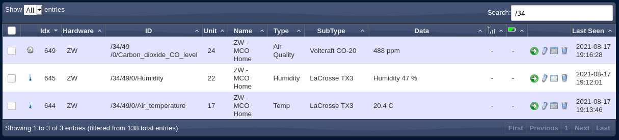

CO2 device is added but it does not communicate the value in PPM to Domoticz when using the correct type "Air Quality". If I change the type to "Usage" or "Illuminance" the value is communicated to the Domoticz UI correctly.
device_types.yml
Domoticz log:
Needs some more debugging.
Btw. I removed the excluded nodes that still had retained messages from the broker using MQTT Explorer.
device_types.yml
Carbon_dioxide_CO_level:
Enabled: true
Primary_device: true
Type: Air Quality
factor: 1
nValue: 0
sValue: valueCode: Select all
2021-08-17 17:58:35.174 ZW: (ZW) zwave/34/49/0/Carbon_dioxide_CO_level
2021-08-17 17:58:35.174 ZW: (ZW) updateDevice called with topic: zwave/34/49/0/Carbon_dioxide_CO_level and payload b'{"time":1629215915139,"value":2000,"nodeName":"MCO Home","nodeLocation":""}'
2021-08-17 17:58:35.175 ZW: (ZW) zwave/34/49/0/Carbon_dioxide_CO_level
2021-08-17 17:58:35.175 ZW: (ZW) Updating unit 24 as device /34/49/0/Carbon_dioxide_CO_level of type Carbon_dioxide_CO_level with {'time': 1629215915139, 'value': 2000, 'nodeName': 'MCO Home', 'nodeLocation': ''}
2021-08-17 17:58:35.175 ZW: (ZW) Updating with typedef: {'Enabled': True, 'Primary_device': True, 'Type': 'Air Quality', 'factor': 1, 'nValue': 0, 'sValue': 'value'}
2021-08-17 17:58:35.175 ZW: (ZW) nValue: 0 sValue: 2000
2021-08-17 17:58:35.175 (ZW - MCO Home) Updating device from 0:'1757' to have values 0:'2000'. Btw. I removed the excluded nodes that still had retained messages from the broker using MQTT Explorer.

It works when assigning "nValue : value" in the devices_types.yml file. I've kept "sValue : value" but don't know if that is needed.
Where would I find this kind of domoticz device requirements (which Type, SubType, value field to use, etc.)?

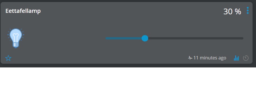

OK, so if 2786 is already a dimmer, you can switch it on/off by clicking on the icon and you can set the dim level with the slider, correct? I suspect the device type exposes an on/off as well but you would not need that device.
I can just click on the light bulb to switch it on/off and use the slider to dim. I can also use dzvents switchOn() and switchOff() as well as dimTo(level) on that device.

Re: zwavejs2mqtt
Well almost.
These domoticz qubino dimmer devices have: 'Set Level' and 'Off' option. No 'On'
I can put it on by setting the level.
But that is a little inconvenient in DzVents.
Does not work then. I have to use something like:
