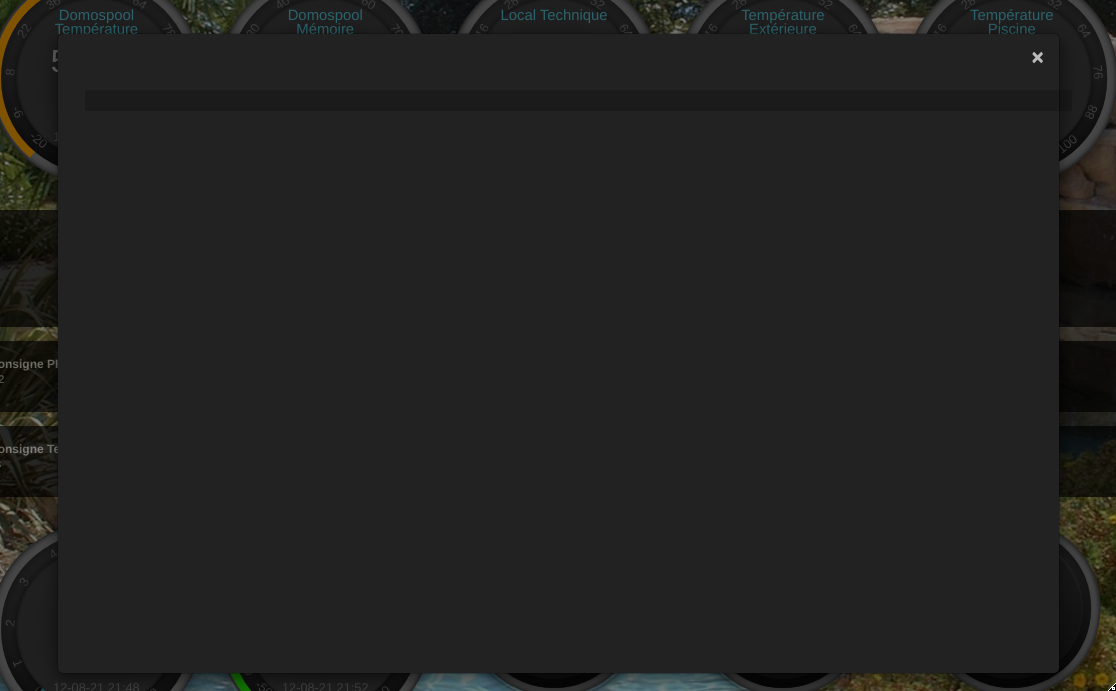

I'm trying to set up a dashboard and I'd like to change some user variables directly from dashticz.
When I tap on the item
My code:
blocks['v7'] = {
  title: "Consigne Température eau",
  icon: 'fas fa-temperature-high'
Is there a way to chnage the user variables from dashticz ?

azer wrote: Friday 13 August 2021 14:16 Is there a way to chnage the user variables from dashticz ?
No.
If you want to change a temperature setpoint, you could create a setpoint device in Domoticz, and use some scripting in Domoticz to copy the device value to a user variable.
A setpoint device can be changed in Dashticz.

thanks it works
