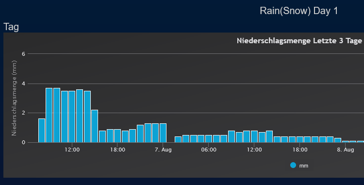

I'm suprised: So this chart means that the forecast was changing quite a lot during the day (0.8 to 3.7mm/day).

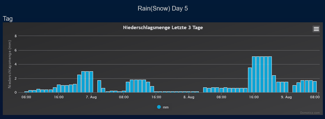

Maybe I don't have to wait. Let's have a look at Day5 where some evening thunderstorms are predicted:
This is exactly the kind of data I would expect to describe an evening thunderstorm prediction. But if each hour would contain the whole amount of rain of the day, then I wonder why the prediction changed so much at around 15:00.
So, this suggests to me that in order to get the whole amount of rain for day5, I would need to sum up all hours of day5 instead of just using 1 data point?

Forecasts can change as they are constantly (hourly or even more often) updated.
But remember that the graph of ‘Day 1’ is showing the forecasts of multiple actual days.
The 3 day ‘Day 1’ graph shows you forecast of 3 different days.
Day - 3 shows you the forecast (changes) for Day - 2
And Day - 2 in the graph shows forecasts for Day - 1
Example. Today is Monday.
The graph shows the last 3 days, so Friday, Saturday and Sunday.
When you look at the forecast values of Friday, they each represent the forecasted total amount of rain for Saturday.
But the Saturday values in the graph show the forecast for Sunday.
And Sunday show the forecast values for today (Monday)
The graph are not very useful as interpretation is not easy.
Are you looking for something special?

I just edited my previous post in parallel. Please have a look at day5.
Anyway, I'll keep an eye on this topic. Thanks for your support!

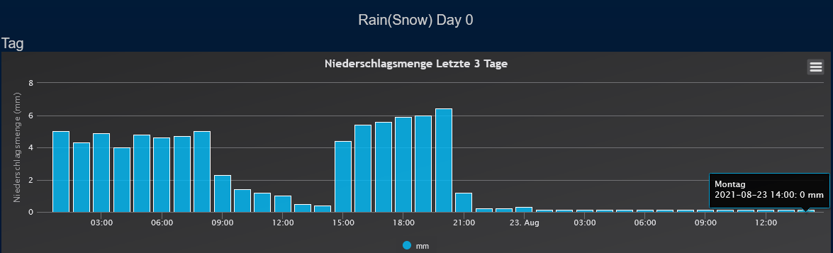

@kiddigital sorry to bother again, but I'm still confused what I'm seeing.
Current value is as shown here:
Unbenanntes Bild.png (6.64 KiB) Viewed 1593 times
History is like this:
Unbenanntes Bild1.png (34.61 KiB) Viewed 1593 times
Which one is the actual current value? 79.7mm or 0 (as shown in the history)?
I assume it's 0.
79.7 is probably the sum of something, which means it must be ignored?
kiddigital
Posts: 454
Re: OpenWeatherMap data interpretation. Is it a forecast?
Post by kiddigital »
Hm... did a little deep dive in some of the Domoticz code on how it handles Rain sensors... and I think that it wasn't designed to handle forecast data :)
It is fine when you just use the actual sensor values representing the current predictions about a future moment. But looking at historical data/graphs on the predicted values, it becomes messy.
Assumption is that it receives actually measured rain/snow (Precipitation) that has fallen. Either as an increasing amount over a day or like a rate (mm/h). Based on these values it creates historical data, like how much rain has fallen in a certain hour in the past.
But when we provide a changing prediction for a whole day, could be high in the beginning but also lower a little later, it should not be processed in the same way.
And currently it does, which could be the reason behind the 'so far unexplainable' historical graphs on prediction data.
Once I have some more time, I will take a look and see if we have to add something to Domoticz to better handle 'future (predicted)' Rain.
Would be a nice feature (no clue yet how hard/impossible it is) if you can 'bind' predictions (sensors) to actual values (sensors) and show them in 1 single graph somehow... The hard part is that you will have multiple predictions on a single 'moment' (day, hour, etc.) and only a single real value... But let's have look :)
