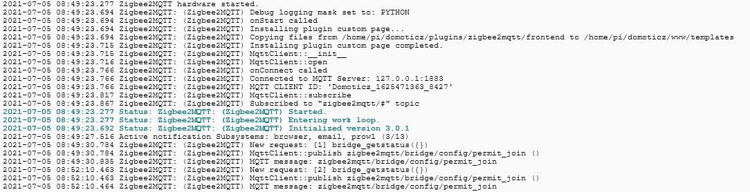

I have installed zigbe2mqtt on a few raspberry pi's with a CC2531 stick correctly flashed etc with no problems. I've just done one for a friend and cannot get it to work correctly, I've followed the instructions to the letter as I've done before, checked the port (ttyACM0) is correct etc and all command line instruction responses come back identical to a working system but when selecting Zigbee2MQTT under the custom tab the screen just says loading all the time and I cannot get the page to load so I can add a device.
I think the domoticz log looks happy and seems to think all is in order.
Domoticz Log.jpg (95.76 KiB) Viewed 1873 times
Anyone have any ideas?

HansOtten
Posts: 50
Joined: Saturday 17 April 2021 9:29
Domoticz version: 2021-1
Location: Mierlo
Re: zigbee2mqtt install issue
Post by HansOtten »
Clean your web browser cache.
Check settings (mqtt, zigbee2mqtt)
Does zigbee2mqtt work, you see the log of zigbee2mqtt filled?
And better replace the ttyacm0 with the physical name of the serial device, Raspberry OS can make a mess of that if there are more serial devices.

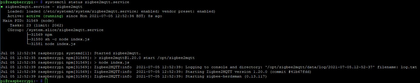

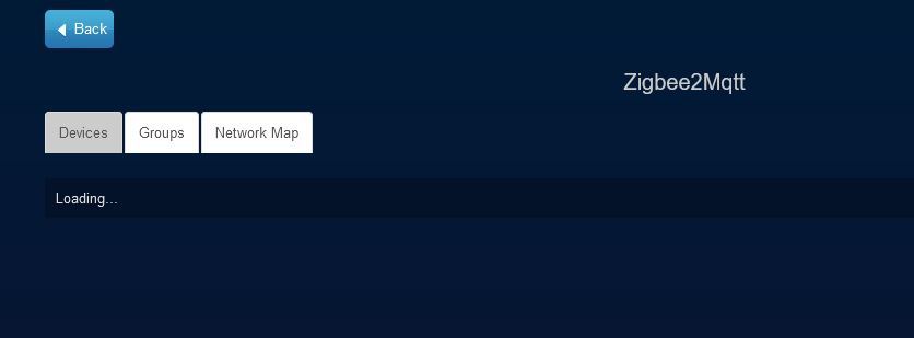

Looks like the zigbee-herdsman service is not started, I don't get an error but it always says starting when you when you send command
systemctl status zigbee2mqtt.service
