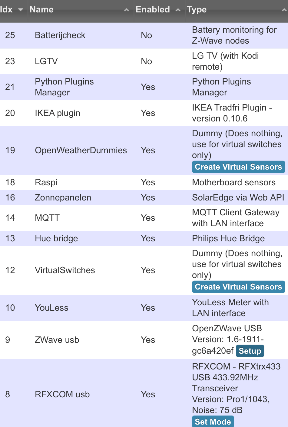

I really keep struggling with this plugin. It works for a while and then these errors appear. And IKEA becomes unresponsive. Also when I disable other hardware/python scripts. Running on a rPi with buster, everything updated.

2021-04-12 16:01:40.465 Error: IKEA plugin hardware (20) thread seems to have ended unexpectedly
2021-04-12 16:01:54.468 Error: IKEA plugin hardware (20) thread seems to have ended unexpectedly
