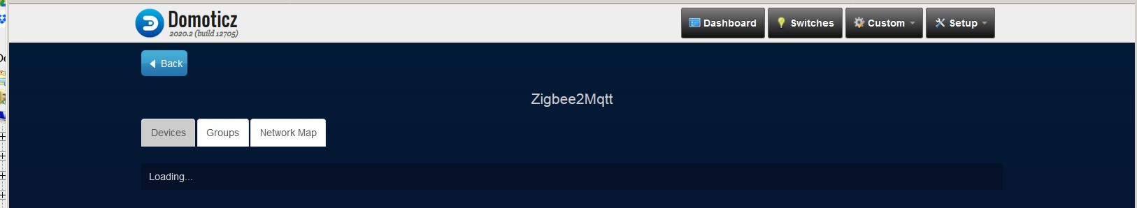

Domotixcz custom zigbee2mqtt.jpg (34.69 KiB) Viewed 1843 times
I presume the new plugin is rendering this page.

I normally use Firefox but it's the same in Chrome and Opera. I cleared the FF cache and reloaded - still the same.
Inspecting the page source I cannot find any mention of "Allow new zigbee devices to join".
So I change the html header from zigbee2mqtt to zigbee2mqtt2 and restarted Domoticz, cleared the browser cache and reloaded the custom zigbee2mqtt page. It now shows the amended header. So the plugin is being used. Still no "Allow new zigbee devices to join" button.
I'm stuck for ideas!
