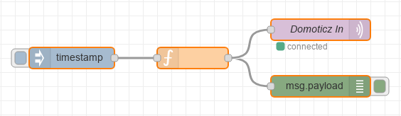

As an example find below a small test flow.
Brief description.
Left you find an "inject" node, just to start the flow. You should replace it with your flow.
Next you will find the function node in order to prepare it for Domoticz.

If you run this flow, you will see in the "debug" node:
The "svalue" is a string consisting of three parameters, separated by a semicolon (;).
So take care that the calculated/collected values for temperature and humidity are string values.
The whole string, you should concatenate it with + sign.

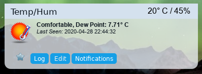

I use in this example a temperature of 20 degrees and a humidity of 45%.
You should finally remove these lines and use the lines that I have commented out (//)
Replace also the IDX (397) for your IDX number.
If everything is correct you will find the next result:
Below you will find the complete flow:

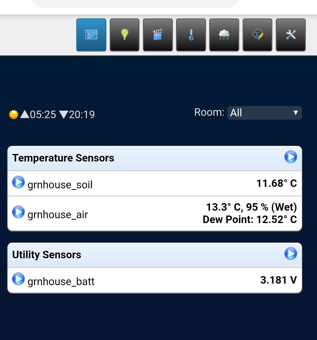

redkooga
- Posts: 4
- Joined: Tuesday 28 April 2020 14:37
Re: mqtt temperature and humidity
thank you that has solved my problem

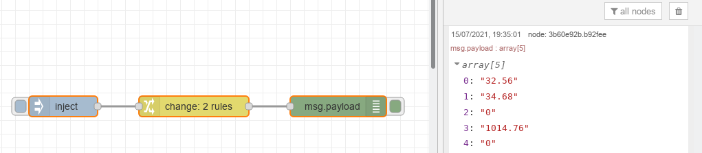

How would it work the other way around? When i have a message with a svalue like:FireWizard wrote: Sunday 22 November 2020 9:59 Hi, @bjornsundberg,

However can you tell me, what the five (not three) values represent?
How do you want the values presented? In an array? Or something else?
I'm currently on a short holiday. I will answer your question and will come up with a solution, as soon as I have returned, as I do not have easy access to Node Red at the moment..

As my previous questions has not been answered (yet), I will inject your string with the "Inject" node.
The string is as follows:
We have several possibilities to solve that and the approach is dependent on what you want with the data.
A flexible way is to put it into an array.
In this case I will use the "Node Red way".
After the "Inject" node, I put a "Change" node and this node does 2 things:
-1 Remove unnecessary characters.
-2 Split the data into the various elements and write it into an array.
The flow and the result looks as follows:
From there you can continue with msg.payload[0], msg.payload[1] and msg.payload[3], etc.
The complete flow is as follows:
If you have more questions, do not hesitate to ask.
It looks, that it is a message received from Domoticz."svalue": "32.56;34.68;0;1014.76;0"
[{"id":"aad7d02a.515ff","type":"inject","z":"26947ec2.64e18a","name":"","props":[{"p":"payload"},{"p":"topic","vt":"str"}],"repeat":"","crontab":"","once":false,"onceDelay":0.1,"topic":"","payload":"svalue\": \"32.56;34.68;0;1014.76;0","payloadType":"str","x":810,"y":160,"wires":[["6a207cd0.e697c4"]]},{"id":"6a207cd0.e697c4","type":"change","z":"26947ec2.64e18a","name":"","rules":[{"t":"change","p":"payload","pt":"msg","from":"svalue\": \"","fromt":"str","to":"","tot":"str"},{"t":"set","p":"payload","pt":"msg","to":"$split(payload,';')","tot":"jsonata"}],"action":"","property":"","from":"","to":"","reg":false,"x":1000,"y":160,"wires":[["3b60e92b.b92fee"]]},{"id":"3b60e92b.b92fee","type":"debug","z":"26947ec2.64e18a","name":"","active":true,"tosidebar":true,"console":false,"tostatus":false,"complete":"false","statusVal":"","statusType":"auto","x":1210,"y":160,"wires":[]}]Regards
