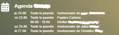

In my gmail calendar I have two birthdays dated 27/06
On the other hand in my dashticz diaries I only find one birthday on 27/06!
Here are my calendar blocks

Dashticz supports two different ical libraries uses for calendar handling. It selects one of them, depending on your PHP version.
What is your PHP version as reported by Dashticz?

My PHP version :
PHP 7.3.27-1~deb10u1 (cli) (built: Feb 13 2021 16:31:40) ( NTS )
Copyright (c) 1997-2018 The PHP Group
Zend Engine v3.3.27, Copyright (c) 1998-2018 Zend Technologies
    with Zend OPcache v7.3.27-1~deb10u1, Copyright (c) 1999-2018, by Zend Technologies

Thanks. I did some tests and found a few issues. I'm working on a fix which I'll try to release within a few days.

I have the fix ready. I have to finalize the testing. I'll release it in 9 days. On holiday at the moment.

Back from holiday :)
Fixed in latest beta. Can you test?

Lokonli wrote: Friday 13 August 2021 15:59 Fixed in latest beta. Can you test?
Yes I do
That is OK

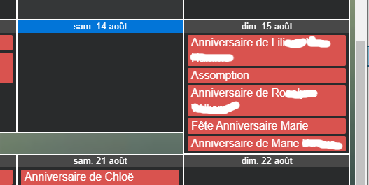

Another suggestion or question.
Is it possible to have different colors depending on the task
Example:
PMC (garbage) in green
Birthday in blue
Holidays in yellow
Appointment to the doctor in red
See my post viewtopic.php?f=67&t=36519

Lokonli
Posts: 2296
Re: Dashticz - Agenda - No display more than one name per day
Post by Lokonli »
Doudy wrote: Tuesday 31 August 2021 8:49 Hello,
Nobody ?
You can combine multiple calendars into one, and assign a color per calendar.
Currently it's not possible to set the color (or CSS class) depending on the content.
But I like the idea, so if you have some coding skills and some time ...

Thank you for the answer.
Lokonli wrote: Sunday 05 September 2021 21:35 You can combine multiple calendars into one, and assign a color per calendar.
My data comes from a single calendar.
It is difficult for me to make a calendar for birthdays, another for visits and another for birthdays, etc ... ;)
Lokonli wrote: Sunday 05 September 2021 21:35 Currently it's not possible to set the color (or CSS class) depending on the content.
That's a shame ... :(
Lokonli wrote: Sunday 05 September 2021 21:35 But I like the idea, so if you have some coding skills and some time ...
I don't think I can code this.
I can't even find where we talk about the color in "calendar.js" :oops:
