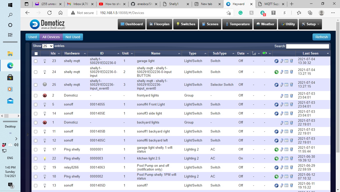

I installed shelly mqtt plugin and MQTT client gateway on my ubuntu server. Also, I set two hardware entries in Domoticz one for the shelly mqtt and another for MQTT client gateway. They are running.
However Domoticz discovered three devices for the same shelly 1 as indicated below and only one of them "garage light" is working. What did I do wrong? My ultimate goal is to have Alexa to discover the "garage light" via Domoticz Bridge. Alexa was able to discover all the dummy switches on domoticz, but not these mqtt devices.

OK, I found one of my problems, you cannot install both shelly mqtt and mqtt gateway in the hardware section of Domoticz. When I stopped the Mqtt gateway, the two devices have disappeared.
Nevertheless, I am still not able to update that mqtt device in Alexa via domoticz bridge.

You can install the shelly mqtt and mqtt gates in the hardware section of Domoticz at the same time, both can work side by side.
Idx 24 and 25 are Input and cannot be controlled. They give the input state when it changes.
to use them in shelly the button must be a separate switch.
Button Type -- Detached Switch

Thank you so much @besix. Now I get it. Can't set that button type, so I just have to forego that status.
