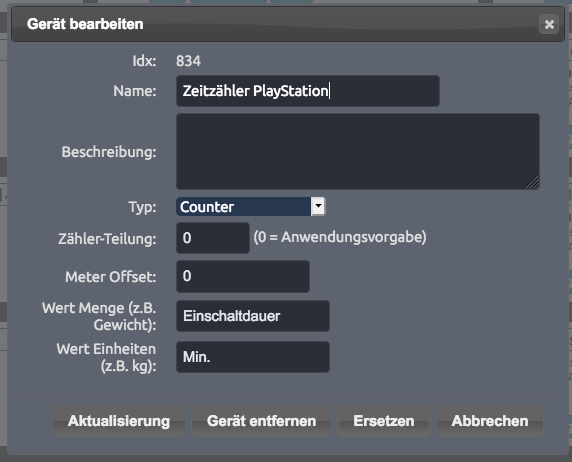

--[[ Little help:
The device which should be counted could be any device you want.
The Counter is an dummy device with this settings:
- Type in setup: Counter
- Type in device configuration: Counter
- Division: 0
- Meter offset: 0

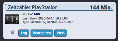

This is an counter, for example the PlayStation:
Bildschirmfoto 2020-04-14 um 17.17.18.png (19.75 KiB) Viewed 1917 times
This are the options form the counter:
Bildschirmfoto 2020-04-14 um 17.17.30.png (48.16 KiB) Viewed 1917 times

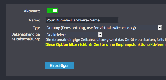

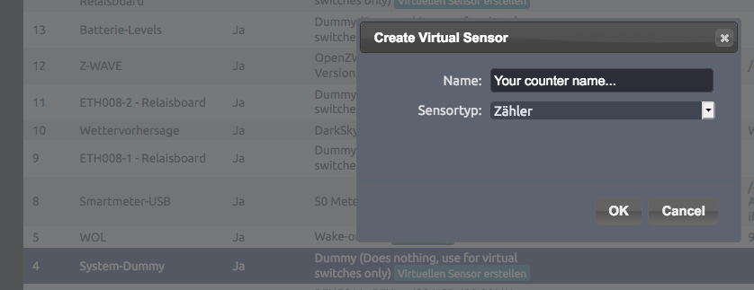

And to get such an counter just an an device in the hardware tab, and then in your dummy hardware "Create device/sensor":
Bildschirmfoto 2020-04-14 um 17.18.55.png (62.05 KiB) Viewed 1917 times
And if you don't have an "dummy hardware" yet, just generate one at the bottom of the hardware page:
Bildschirmfoto 2020-04-14 um 17.22.27.png (36.96 KiB) Viewed 1917 times
