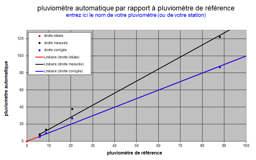

I performed a calibration according to the french standard: a 400 cm² no-name rainmeter, copy of the too expensive certified for France SPIEA rainmeter. The standard rain surface to collect differs with country: 400cm² for France, 200 cm² for Switzerland , I don't know for the other.
Here is the calibration graph. The black line is the raw line (without calibration and the blue line is calibrated line). The calibration coefficient is 0.709
! This is huge. You can find the excel file in the infoclimat link.

Interesting to know, the measurement error is quite high. You could maybe report that to the Popp-rain manufacturer.

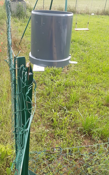

I will try to move my rainmeter. Maybe, it's not far enough from the wall and roof...

Rain count can give very big differences between station/locations.
If you would measure 1 meter away from your rainmeter you already could have a big difference.
The Popp rain sensor measures with increments of 0.5mm/m2 rain. And is constructed this way to function properly.
If you want to see if your Popp rainmeter is working correctly you must calculate a given amount of rainfall, and pour this slowly into the Popp rainmeter and see if the theoretical value you calculated is roughly the same as it shows up in Domoticz. If this is correct, than your Popp is working correctly. (max. precision as stated in the documentation of the rain meter is 3,5 mm rain per
hour). If this all checks out the difference compared with the rain station at the other location is just that... the real difference in rainfall between your location and the other station.
You want to know the real rainfall at your location I would say, and not "calibrate" to run in line with a rainmeter at a other place?
For what I can see on your photo is that you will get a smaller rain count when the wind blows from left over the roof when it rains.
Put it a bit higher, slightly above the roof or at a other location with no restriction around it.
But perhaps I don't understand you correctly, in that case just ignore my remarks

No I have higher rain count with zrain, not smaller rain count: zrain count=1.41*manual countJackD wrote: Sunday 23 May 2021 20:33 For what I can see on your photo is that you will get a smaller rain count when the wind blows from left over the roof when it rains.
That's strange but that's it.
I moved the zrain in the middle of my garden and the measure seem to be better. News soon at the next rain...
Domoticz V2024.7

I moved the zrain on the fence, far from the wall:
There is no improvement.
It rained 43mm according to zrain and 30mm according to my manual pluviometer.
Base on 9 samples, my conversion factor is 1.40
Your conversion factor is 120mm/89mm=1.35 base on 1 sample. We can say this factor is similar to mine.ricdom wrote: Friday 28 May 2021 19:24 I have seen exactly the same problem with accuracy. We had for our area quite a heavy rain over two days a few days ago. Zrain (mounted on an open, free place) reported 120 mm. A few meter from it was an empty bucket standing on a similarily open place. In the bucket there were 4.36 liters of water when it stopped raining and the diameter of the bucket is 25 cm. If I calculate correctly (4.36/(0.125*0.125*pi)) that would be about 89 mm which is not too far away from what the weather service meassured some kilometer away, 77 mm. They report 0.1-6.0 mm/hour. Zpopp on the other hand is way off which is very disturbing.

New erroneous value with my z-rain: 144899.1mm for July 13th!
Is this a domoticz or z-rain problem? Should I send back the z-rain?
I installed my TFA 30.3233.01: RFXCOM connection with pro2 firmware 1044 updated within domoticz.
I compared the value with my analog rainmeter.
The multiply factor is 2.5 to have the correct value (domoticz/edit device/multiply)
2.5 is very close to 2.54: the correction factor between cm and inch...
If somebody have the version with display 47.3005.01 and an analog rainmeter, we could know this is a domoticz or TFA rainmeter problem.
Note: the multiply factor for my z-rain is 0.71
