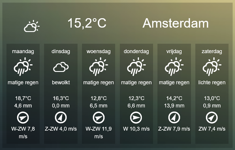

Nefsolive
- Posts: 69
- Joined: Monday 04 September 2017 17:13
Re: Dashticz v3.8.2 beta: New weather block
Good,
My icons weather have changed to black color and I'm not able to change the color of the icons.
I've already tried this code, but it's not working!
blocks['weather4'] = {
type: 'weather',
layout: 4,
count: 6,
showDetails: false,
showHourly: false,
// monochrome: true,
colors: {
cloud: 'orange',
light_cloud: 'orange',
dark_cloud: 'orange',
Any idea to change color?
Ty
type: 'weather',
layout: 4,
count: 6,
showDetails: false,
showHourly: false,
colors: {
cloud: 'orange',
Ty
- 1.jpg (11.62 KiB) Viewed 2380 times
Nefsolive
- Posts: 69
Everythink is ok!
They was browser cache.
