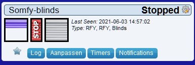

For people interested:
The original somfy remote can not be paired as a on/off switch so an on/off/stop command can not be received via Domoticz /RFxcom. A somfyremote command does not change the blindsswitch.
Somfy blinds.jpg (18.29 KiB) Viewed 604 times
So if your wife uses the Somfy remotecontrol and you always use Domoticz you have a problem.
Starting point: Somfy blinds are paired (see RFXcom user manual)
Solution:

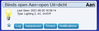

Buy a simple KlikonKlifoff remote.
Add an on/off switch for opening and closing the blinds.
Blinds open-dicht.jpg (18.29 KiB) Viewed 604 times

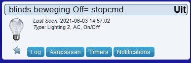

Add an on/off switch for for stopping the movement of the blinds
Blinds stop.jpg (17.81 KiB) Viewed 604 times
With the KlikonKlifoff remote you can control two switches. Two little scripts will direct your Somfy blindsswitch.
    active = true,
        devices = {
            6904   --- blinds open/dicht switch
    execute = function(domoticz, switch)
         domoticz.log('===blinds script==================')
        if (switch.state == 'On') then
            domoticz.log('===blinds open ====================')
            --domoticz.notify('Blinds open', 'Blinds open', domoticz.PRIORITY_LOW)
            domoticz.devices('Somfy-blinds').switchOff()    --somfy
            domoticz.log('===blinds dicht ====================')
            --domoticz.notify('Blinds Erwin dicht', 'Blinds dicht', domoticz.PRIORITY_LOW)
            domoticz.devices('Somfy-blinds').switchOn()
    active = true,
        devices = {
            6906   --- blinds stop
        if (switch.state == 'Off') then
            domoticz.log('===blinds gestopt ====================')
            --domoticz.notify('Blinds gestopt', 'Blinds beweging gestopt', domoticz.PRIORITY_LOW)
            domoticz.devices('Somfy-blinds').stop()    --somfy
