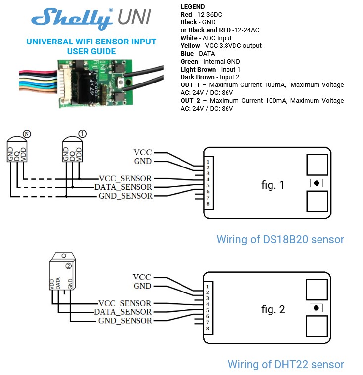

In my house I have serveral temperature sensors DHT22 with a wired connection to my Raspberry. I want to add a sensor at al long distance from my Raspberry. I found in the specs of a Shelly UNI that you can connect a DHT22.
Has anyone experience with the combination DHT22 to Shelly UNI to Domoticz?

- Schermafbeelding 2021-06-03 200059.jpg (94.41 KiB) Viewed 3344 times

if you can handle it you can use a Wemos mini D1 Pro with Espeasy software. the temperature sensor DS1820 can be connected to this and many other sensors (Lux, Barometer, etc.) and even switches.

The Shelly temperature sensor add-on for Shelly 1/1PM is an additional module to connect up to 3 DS18B20 temperature sensors or 1 DHT22 temperature and humidity sensor to a Shelly 1 or Shelly 1PM.
