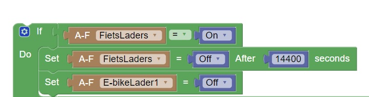

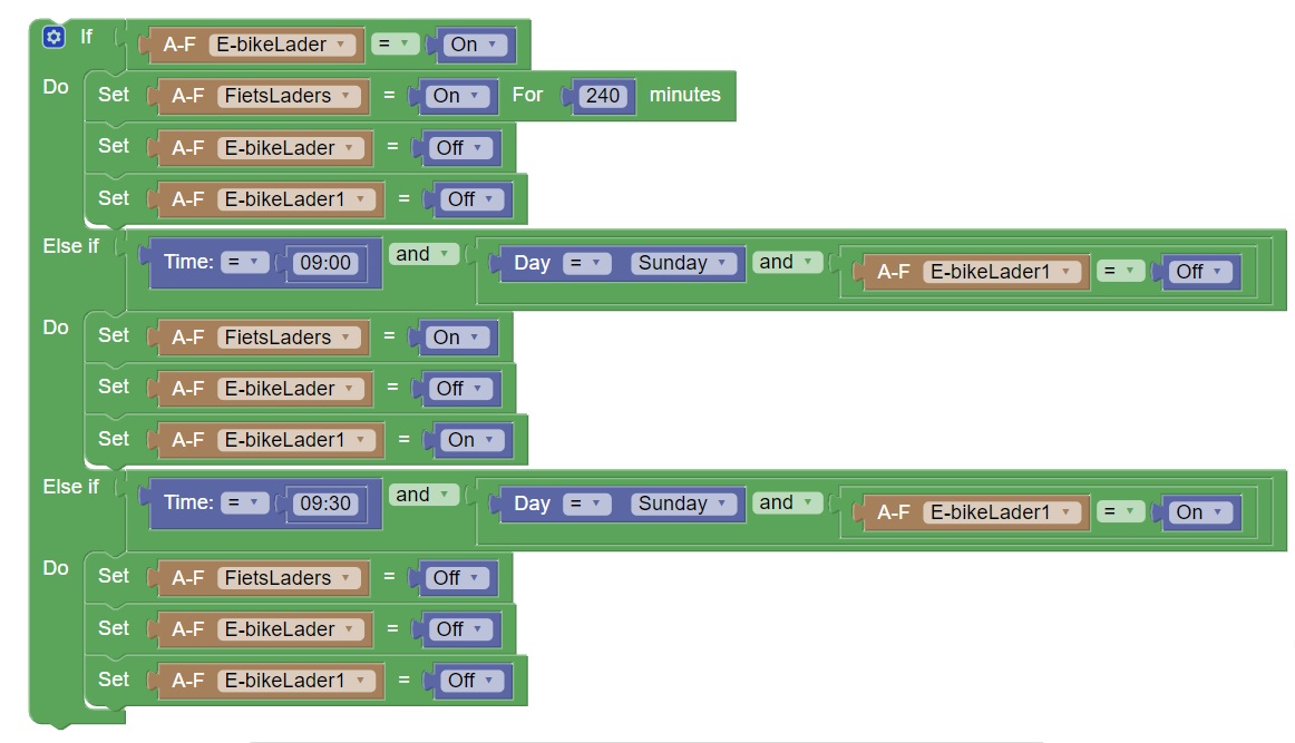

I wrote a Blocky script to switch on/off my e-bike charger.
When I manual switch it on it has to be off after 4 hours (240 min)
E-bikeLader and E-bikeLader1 is a dummy switch, FietsLaders is the switch.
When I use 5 or 30 or 60 minutes it works fine but with 240 minutes blocky does not switch off after 240 minutes.
Can someone help me if I do somthings wrong or is this a bug in 2021.1 build 13.222

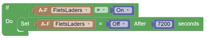

Try to use,
IF E-bikelader = ON
SET E-bikelader = OFF after 14400 seconds
I use this 3 hours blockly (10800 sec.) for years now.
IF E-bikelader = ON

@Treve thank you for yuour responce.
I changed the blokly but after 4 1/2 hour it was still on.
I changed the name E-bikeLader to FietsLaders because E-bikeLader is a dummy and FietsLaders is the switch.

Doesn't it do a "set FietsLaders Off after 14400" each minute making it never switch off? (I am not too familiar with Blockly as I prefer coding it in LUA.

Try removing the lines that test for the Sunday time as those make this script a Time script, which means it will run each minute.
So just try the top part as shown in this post without anything else in it:

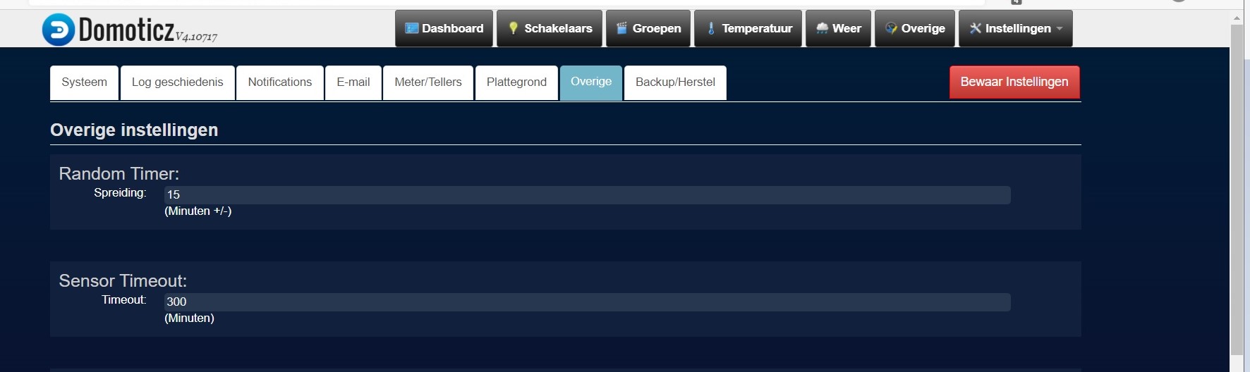

In settings the timeout sensors were set to 60 min, I set this to 300 min.
I just restarted the timer and will see if it turns off in 2 hours.
I already did it.

Guess you mean to say 120 minutes as 300min = 5 hours!Pierre1958 wrote: Wednesday 02 June 2021 13:15 In settings the timeout sensors were set to 60 min, I set this to 300 min.
You have also set the Trigger field to "Device" !?

Setting the senor timeout value to 300 min didn't help.

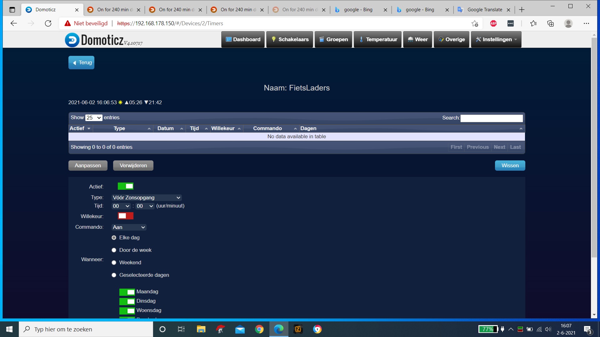

What do you mean by set the Trigger field to "Device"?
Is it a must to set a time here?
Whatever I do the timer works for up to 60 minutes. Within this time it switches off correctly.
If I now want to extend the switch-off time to, for example, 120 minutes, it will NOT switch off anymore.
It seems like there is a 60 minute timer block on somewhere or Domoticz restarts after 60 minutes and Blockly doesn't remember its turn on time or even Blockly stops altogether.
- Posts: 6683
- Domoticz version: 2025.1
Re: On for 240 min does not work
I think @jvdz is referring to the Blockly Triggers: https://www.domoticz.com/wiki/Blockly#Triggers
If you want to trigger on a device change as in your case you should use the device Trigger (pull down menu in Edit Blockly Events page). Default it is set to "All" so every minute it will run and (re)set the delay.
A total different approach would be to use the Off Delay in Device Edit form: https://www.domoticz.com/wiki/Managing_ ... _Off_Delay
(note that is differnt than the off delay in a Scene or Group: The Off delay on switch device in a Group/Scene causes a device to switch Off with a delay of the set amount of seconds after the switchOff command is given. )
The Off delay on a switch device causes a device to switch Off with a delay of the set amount of seconds after the device switched to On.
