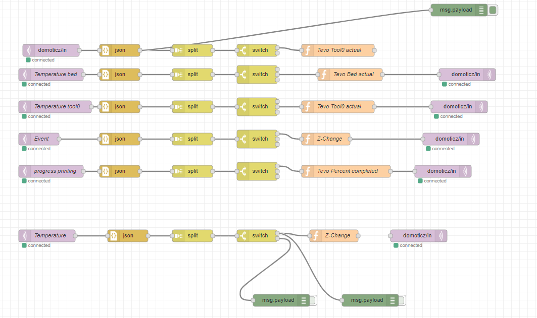

finally im trying to configure MQTT in domoticz :-)
now i need to create the node-red flow. im in progres!!! :-P
edit:
I install MQTT and node. but im very lost with this.
Im really noobs with this and i dont know how to create the node flow and link the octoprint plugin (mqtt) to send the info to node and domoticz :-(
some help?
thanksssss
EDIT2:
works! this not so easy but fine

@DAVIZINHO
I did describe exactly how to paste in the node flow - maybe you didn't read this... anyway I will then post the link:
viewtopic.php?f=21&t=14021#p162935my guide?

bjacobse wrote: Thursday 29 November 2018 22:52 @DAVIZINHO
yes I read but only apears the "orange box" not the others.
This was the first time i use node, maybe my fault but like I said, i can solve the problem and now it works perfect! :-)

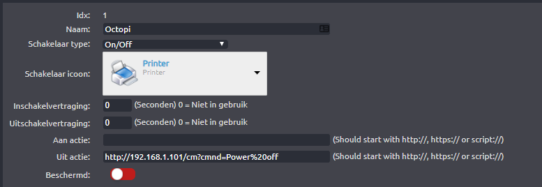

Hi, i just want let you see what i made untill to now.
Switching the printer on and off does not require a plugin. I put a Sonoff POW between the power cord. The sonoff is flashed with Tasmota.
I switch the printer on with it and i can follow up on the power use. Then i created a Domoticz keep alive on the Octoprint IP address. In the keep alive switch i put the off command for the sonoff.
When Domoticz now sees that the Octoprint is not responding it will send a poweroff signal to the sonoff.

For monitoring Octoprint i use Node Red. First you have to add the MQTT plugin to Octoprint.
In Node Red i use the following flow:
I still haven't figured out how to put the time estmates in it but this works mutch better than the Lue script i used before. The script made Domoticz unstable (timeouts).
The Node Red code is below, please enhance and correct if you want.
[{"id":"38d87d0c.c0dba2","type":"tab","label":"Octoprint","disabled":false,"info":""},{"id":"83a9a492.59f388","type":"mqtt in","z":"38d87d0c.c0dba2","name":"Temperature bed","topic":"octoprint/temperature/bed/#","qos":"0","datatype":"auto","broker":"146ca2a1.e14f9d","x":160,"y":200,"wires":[["2b228f31.950f5"]]},{"id":"2b228f31.950f5","type":"json","z":"38d87d0c.c0dba2","name":"","property":"payload","action":"obj","pretty":false,"x":330,"y":200,"wires":[["ca948c99.4302"]]},{"id":"ad308bc2.753d38","type":"switch","z":"38d87d0c.c0dba2","name":"","property":"topic","propertyType":"msg","rules":[{"t":"eq","v":"_timestamp","vt":"str"},{"t":"eq","v":"actual","vt":"str"},{"t":"eq","v":"target","vt":"str"}],"checkall":"true","repair":false,"outputs":3,"x":670,"y":200,"wires":[[],["47c48783.f78178"],[]]},{"id":"ca948c99.4302","type":"split","z":"38d87d0c.c0dba2","name":"","splt":"\\n","spltType":"str","arraySplt":1,"arraySpltType":"len","stream":false,"addname":"topic","x":510,"y":200,"wires":[["ad308bc2.753d38"]]},{"id":"2a937535.2fe7aa","type":"mqtt out","z":"38d87d0c.c0dba2","name":"","topic":"domoticz/in","qos":"","retain":"","broker":"146ca2a1.e14f9d","x":1190,"y":200,"wires":[]},{"id":"47c48783.f78178","type":"function","z":"38d87d0c.c0dba2","name":"Tevo Bed actual","func":"var msg_out = {payload: msg.payload.length};\nmsg_out.payload = {};\nmsg_out.payload.idx = 486;\nmsg_out.payload.nvalue = 0;\nmsg_out.payload.svalue = \"\" + msg.payload;\nreturn msg_out;","outputs":1,"noerr":0,"x":900,"y":200,"wires":[["2a937535.2fe7aa"]]},{"id":"d17f01b0.d3db5","type":"mqtt in","z":"38d87d0c.c0dba2","name":"Temperature tool0","topic":"octoprint/temperature/tool0/#","qos":"0","datatype":"auto","broker":"146ca2a1.e14f9d","x":170,"y":280,"wires":[["d457f05.7c9b91"]]},{"id":"d457f05.7c9b91","type":"json","z":"38d87d0c.c0dba2","name":"","property":"payload","action":"obj","pretty":false,"x":330,"y":280,"wires":[["acab5c8.cb217a"]]},{"id":"e4654870.da4c68","type":"switch","z":"38d87d0c.c0dba2","name":"","property":"topic","propertyType":"msg","rules":[{"t":"eq","v":"_timestamp","vt":"str"},{"t":"eq","v":"actual","vt":"str"},{"t":"eq","v":"target","vt":"str"}],"checkall":"true","repair":false,"outputs":3,"x":670,"y":280,"wires":[[],["4dd5e474.0e389c"],[]]},{"id":"acab5c8.cb217a","type":"split","z":"38d87d0c.c0dba2","name":"","splt":"\\n","spltType":"str","arraySplt":1,"arraySpltType":"len","stream":false,"addname":"topic","x":510,"y":280,"wires":[["e4654870.da4c68"]]},{"id":"4dd5e474.0e389c","type":"function","z":"38d87d0c.c0dba2","name":"Tevo Tool0 actual","func":"var msg_out = {payload: msg.payload.length};\nmsg_out.payload = {};\nmsg_out.payload.idx = 487;\nmsg_out.payload.nvalue = 0;\nmsg_out.payload.svalue = \"\" + msg.payload;\nreturn msg_out;","outputs":1,"noerr":0,"x":870,"y":280,"wires":[["936e5378.7484a"]]},{"id":"936e5378.7484a","type":"mqtt out","z":"38d87d0c.c0dba2","name":"","topic":"domoticz/in","qos":"","retain":"","broker":"146ca2a1.e14f9d","x":1170,"y":280,"wires":[]},{"id":"951dd801.bbe048","type":"mqtt in","z":"38d87d0c.c0dba2","name":"Event","topic":"octoprint/event/#","qos":"0","datatype":"auto","broker":"146ca2a1.e14f9d","x":130,"y":360,"wires":[["80e4a78f.32d5e8"]]},{"id":"80e4a78f.32d5e8","type":"json","z":"38d87d0c.c0dba2","name":"","property":"payload","action":"obj","pretty":false,"x":330,"y":360,"wires":[["31b12dfb.52b212"]]},{"id":"86831727.6e41c8","type":"switch","z":"38d87d0c.c0dba2","name":"","property":"topic","propertyType":"msg","rules":[{"t":"eq","v":"new","vt":"str"},{"t":"eq","v":"_event","vt":"str"},{"t":"eq","v":"state_id","vt":"str"}],"checkall":"true","repair":false,"outputs":3,"x":670,"y":360,"wires":[["41fa892d.c97508"],[],[]]},{"id":"31b12dfb.52b212","type":"split","z":"38d87d0c.c0dba2","name":"","splt":"\\n","spltType":"str","arraySplt":1,"arraySpltType":"len","stream":false,"addname":"topic","x":510,"y":360,"wires":[["86831727.6e41c8"]]},{"id":"e6ce789c.9c1468","type":"mqtt out","z":"38d87d0c.c0dba2","name":"","topic":"domoticz/in","qos":"","retain":"","broker":"146ca2a1.e14f9d","x":1150,"y":360,"wires":[]},{"id":"41fa892d.c97508","type":"function","z":"38d87d0c.c0dba2","name":"Z-Change","func":"var msg_out = {payload: msg.payload.length};\nmsg_out.payload = {};\nmsg_out.payload.idx = 494;\nmsg_out.payload.nvalue = 0;\nmsg_out.payload.svalue = \"\" + msg.payload;\nreturn msg_out;","outputs":1,"noerr":0,"x":840,"y":360,"wires":[["e6ce789c.9c1468"]]},{"id":"17a3b4d.9bb8a4b","type":"mqtt in","z":"38d87d0c.c0dba2","name":"Temperature","topic":"octoprint/temperature/#","qos":"0","datatype":"auto","broker":"146ca2a1.e14f9d","x":150,"y":600,"wires":[["89bcf392.ef067"]]},{"id":"89bcf392.ef067","type":"json","z":"38d87d0c.c0dba2","name":"","property":"payload","action":"obj","pretty":false,"x":350,"y":600,"wires":[["f4d9f431.321e88"]]},{"id":"65f60dda.fb0c74","type":"switch","z":"38d87d0c.c0dba2","name":"","property":"topic","propertyType":"msg","rules":[{"t":"eq","v":"tool0/target","vt":"str"},{"t":"eq","v":"bed/target","vt":"str"}],"checkall":"true","repair":false,"outputs":2,"x":670,"y":600,"wires":[["958b89f0.71e238","9443b17.48e4e5"],["334563e7.92e08c"]]},{"id":"f4d9f431.321e88","type":"split","z":"38d87d0c.c0dba2","name":"","splt":"\\n","spltType":"str","arraySplt":1,"arraySpltType":"len","stream":false,"addname":"topic","x":510,"y":600,"wires":[["65f60dda.fb0c74"]]},{"id":"c79822ad.a78fb","type":"function","z":"38d87d0c.c0dba2","name":"Tevo Percent completed","func":"var msg_out = {payload: msg.payload.length};\nmsg_out.payload = {};\nmsg_out.payload.idx = 489;\nmsg_out.payload.nvalue = 0;\nmsg_out.payload.svalue = \"\" + msg.payload;\nreturn msg_out;","outputs":1,"noerr":0,"x":890,"y":440,"wires":[["e2d967a3.4e77e8"]]},{"id":"e2d967a3.4e77e8","type":"mqtt out","z":"38d87d0c.c0dba2","name":"","topic":"domoticz/in","qos":"","retain":"","broker":"146ca2a1.e14f9d","x":1130,"y":440,"wires":[]},{"id":"334563e7.92e08c","type":"debug","z":"38d87d0c.c0dba2","name":"","active":false,"tosidebar":true,"console":false,"tostatus":false,"complete":"false","x":730,"y":760,"wires":[]},{"id":"e6c2abcf.387108","type":"mqtt in","z":"38d87d0c.c0dba2","name":"progress printing","topic":"octoprint/progress/printing/#","qos":"0","datatype":"auto","broker":"146ca2a1.e14f9d","x":160,"y":440,"wires":[["bf782295.52d9f"]]},{"id":"bf782295.52d9f","type":"json","z":"38d87d0c.c0dba2","name":"","property":"payload","action":"obj","pretty":false,"x":330,"y":440,"wires":[["318d70a3.89a55"]]},{"id":"dfa8fb0c.451448","type":"switch","z":"38d87d0c.c0dba2","name":"","property":"topic","propertyType":"msg","rules":[{"t":"eq","v":"progress","vt":"str"},{"t":"eq","v":"printer_data","vt":"str"},{"t":"eq","v":"state","vt":"str"}],"checkall":"true","repair":false,"outputs":3,"x":670,"y":440,"wires":[["c79822ad.a78fb"],[],[]]},{"id":"318d70a3.89a55","type":"split","z":"38d87d0c.c0dba2","name":"","splt":"\\n","spltType":"str","arraySplt":1,"arraySpltType":"len","stream":false,"addname":"topic","x":510,"y":440,"wires":[["dfa8fb0c.451448"]]},{"id":"5c057964.e50628","type":"mqtt out","z":"38d87d0c.c0dba2","name":"","topic":"domoticz/in","qos":"","retain":"","broker":"146ca2a1.e14f9d","x":1070,"y":600,"wires":[]},{"id":"958b89f0.71e238","type":"function","z":"38d87d0c.c0dba2","name":"Z-Change","func":"var msg_out = {payload: msg.payload.length};\nmsg_out.payload = {};\nmsg_out.payload.idx = 494;\nmsg_out.payload.nvalue = 0;\nmsg_out.payload.svalue = \"\" + msg.payload;\nreturn msg_out;","outputs":1,"noerr":0,"x":860,"y":600,"wires":[[]]},{"id":"9443b17.48e4e5","type":"debug","z":"38d87d0c.c0dba2","name":"","active":false,"tosidebar":true,"console":false,"tostatus":false,"complete":"false","x":950,"y":760,"wires":[]},{"id":"698e4eae.aece8","type":"mqtt in","z":"38d87d0c.c0dba2","name":"","topic":"domoticz/in","qos":"2","datatype":"auto","broker":"42c17f80.3e1c4","x":160,"y":140,"wires":[["c9416bae.dcc038"]]},{"id":"e3788ef3.70e57","type":"debug","z":"38d87d0c.c0dba2","name":"","active":true,"tosidebar":true,"console":false,"tostatus":false,"complete":"false","x":1170,"y":40,"wires":[]},{"id":"c9416bae.dcc038","type":"json","z":"38d87d0c.c0dba2","name":"","property":"payload","action":"obj","pretty":false,"x":330,"y":140,"wires":[["3aa9e07d.ade04","e3788ef3.70e57"]]},{"id":"8bc22ae7.083688","type":"switch","z":"38d87d0c.c0dba2","name":"","property":"payload","propertyType":"msg","rules":[{"t":"istype","v":"string","vt":"string"},{"t":"istype","v":"boolean","vt":"boolean"}],"checkall":"true","repair":false,"outputs":2,"x":670,"y":140,"wires":[["9174d3d5.a0ca"],[]]},{"id":"3aa9e07d.ade04","type":"split","z":"38d87d0c.c0dba2","name":"","splt":"\\n","spltType":"str","arraySplt":1,"arraySpltType":"len","stream":false,"addname":"topic","x":510,"y":140,"wires":[["8bc22ae7.083688"]]},{"id":"9174d3d5.a0ca","type":"function","z":"38d87d0c.c0dba2","name":"Tevo Tool0 actual","func":"var msg_out = {payload: msg.payload.length};\nmsg_out.payload = {};\nmsg_out.payload.idx = 484;\nmsg_out.payload.nvalue = 0;\nmsg_out.payload.svalue = \"\" + msg.payload;\nreturn msg_out;","outputs":1,"noerr":0,"x":870,"y":140,"wires":[[]]},{"id":"146ca2a1.e14f9d","type":"mqtt-broker","z":"","name":"","broker":"192.168.1.11","port":"1883","clientid":"","usetls":false,"compatmode":true,"keepalive":"60","cleansession":true,"birthTopic":"","birthQos":"0","birthPayload":"","closeTopic":"","closeQos":"0","closePayload":"","willTopic":"","willQos":"0","willPayload":""},{"id":"42c17f80.3e1c4","type":"mqtt-broker","z":"","name":"","broker":"192.168.1.11","port":"1883","clientid":"","usetls":false,"compatmode":true,"keepalive":"60","cleansession":true,"birthTopic":"","birthQos":"0","birthPayload":"","closeTopic":"","closeQos":"0","closePayload":"","willTopic":"","willQos":"0","willPayload":""}]

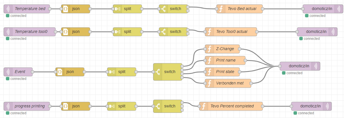

I have been working on this, this should be better.
But there is still room for improvement.
[{"id":"38d87d0c.c0dba2","type":"tab","label":"Octoprint","disabled":false,"info":""},{"id":"83a9a492.59f388","type":"mqtt in","z":"38d87d0c.c0dba2","name":"Temperature bed","topic":"octoPrint/temperature/bed/#","qos":"0","datatype":"auto","broker":"146ca2a1.e14f9d","x":160,"y":200,"wires":[["2b228f31.950f5"]]},{"id":"2b228f31.950f5","type":"json","z":"38d87d0c.c0dba2","name":"","property":"payload","action":"obj","pretty":false,"x":330,"y":200,"wires":[["ca948c99.4302"]]},{"id":"ad308bc2.753d38","type":"switch","z":"38d87d0c.c0dba2","name":"","property":"topic","propertyType":"msg","rules":[{"t":"eq","v":"actual","vt":"str"},{"t":"eq","v":"target","vt":"str"}],"checkall":"true","repair":false,"outputs":2,"x":670,"y":200,"wires":[["47c48783.f78178"],[]]},{"id":"ca948c99.4302","type":"split","z":"38d87d0c.c0dba2","name":"","splt":"\\n","spltType":"str","arraySplt":1,"arraySpltType":"len","stream":false,"addname":"topic","x":510,"y":200,"wires":[["ad308bc2.753d38"]]},{"id":"2a937535.2fe7aa","type":"mqtt out","z":"38d87d0c.c0dba2","name":"","topic":"domoticz/in","qos":"","retain":"","broker":"146ca2a1.e14f9d","x":1190,"y":200,"wires":[]},{"id":"47c48783.f78178","type":"function","z":"38d87d0c.c0dba2","name":"Tevo Bed actual","func":"var msg_out = {payload: msg.payload.length};\nmsg_out.payload = {};\nmsg_out.payload.idx = 486;\nmsg_out.payload.nvalue = 0;\nmsg_out.payload.svalue = \"\" + msg.payload;\nreturn msg_out;","outputs":1,"noerr":0,"x":900,"y":200,"wires":[["2a937535.2fe7aa"]]},{"id":"d17f01b0.d3db5","type":"mqtt in","z":"38d87d0c.c0dba2","name":"Temperature tool0","topic":"octoPrint/temperature/tool0/#","qos":"0","datatype":"auto","broker":"146ca2a1.e14f9d","x":170,"y":280,"wires":[["d457f05.7c9b91"]]},{"id":"d457f05.7c9b91","type":"json","z":"38d87d0c.c0dba2","name":"","property":"payload","action":"obj","pretty":false,"x":330,"y":280,"wires":[["acab5c8.cb217a"]]},{"id":"e4654870.da4c68","type":"switch","z":"38d87d0c.c0dba2","name":"","property":"topic","propertyType":"msg","rules":[{"t":"eq","v":"actual","vt":"str"},{"t":"eq","v":"target","vt":"str"}],"checkall":"true","repair":false,"outputs":2,"x":670,"y":280,"wires":[["4dd5e474.0e389c"],[]]},{"id":"acab5c8.cb217a","type":"split","z":"38d87d0c.c0dba2","name":"","splt":"\\n","spltType":"str","arraySplt":1,"arraySpltType":"len","stream":false,"addname":"topic","x":510,"y":280,"wires":[["e4654870.da4c68"]]},{"id":"4dd5e474.0e389c","type":"function","z":"38d87d0c.c0dba2","name":"Tevo Tool0 actual","func":"var msg_out = {payload: msg.payload.length};\nmsg_out.payload = {};\nmsg_out.payload.idx = 487;\nmsg_out.payload.nvalue = 0;\nmsg_out.payload.svalue = \"\" + msg.payload;\nreturn msg_out;","outputs":1,"noerr":0,"x":870,"y":280,"wires":[["936e5378.7484a"]]},{"id":"936e5378.7484a","type":"mqtt out","z":"38d87d0c.c0dba2","name":"","topic":"domoticz/in","qos":"","retain":"","broker":"146ca2a1.e14f9d","x":1170,"y":280,"wires":[]},{"id":"951dd801.bbe048","type":"mqtt in","z":"38d87d0c.c0dba2","name":"Event","topic":"octoPrint/event/#","qos":"0","datatype":"auto","broker":"146ca2a1.e14f9d","x":130,"y":420,"wires":[["80e4a78f.32d5e8"]]},{"id":"80e4a78f.32d5e8","type":"json","z":"38d87d0c.c0dba2","name":"","property":"payload","action":"obj","pretty":false,"x":310,"y":420,"wires":[["31b12dfb.52b212"]]},{"id":"86831727.6e41c8","type":"switch","z":"38d87d0c.c0dba2","name":"","property":"topic","propertyType":"msg","rules":[{"t":"eq","v":"new","vt":"str"},{"t":"eq","v":"name","vt":"str"},{"t":"eq","v":"state_string","vt":"str"},{"t":"eq","v":"remoteAddress","vt":"str"}],"checkall":"true","repair":false,"outputs":4,"x":650,"y":420,"wires":[["41fa892d.c97508"],["67e3be2b.81457"],["5bd8d405.b9397c"],["7b47cf98.3fcd4"]]},{"id":"31b12dfb.52b212","type":"split","z":"38d87d0c.c0dba2","name":"","splt":"\\n","spltType":"str","arraySplt":1,"arraySpltType":"len","stream":false,"addname":"topic","x":490,"y":420,"wires":[["86831727.6e41c8"]]},{"id":"41fa892d.c97508","type":"function","z":"38d87d0c.c0dba2","name":"Z-Change","func":"var msg_out = {payload: msg.payload.length};\nmsg_out.payload = {};\nmsg_out.payload.idx = 494;\nmsg_out.payload.nvalue = 0;\nmsg_out.payload.svalue = \"\" + msg.payload;\nreturn msg_out;","outputs":1,"noerr":0,"x":840,"y":340,"wires":[["66175381.fac34c"]]},{"id":"c79822ad.a78fb","type":"function","z":"38d87d0c.c0dba2","name":"Tevo Percent completed","func":"var msg_out = {payload: msg.payload.length};\nmsg_out.payload = {};\nmsg_out.payload.idx = 489;\nmsg_out.payload.nvalue = 0;\nmsg_out.payload.svalue = \"\" + msg.payload;\nreturn msg_out;","outputs":1,"noerr":0,"x":870,"y":540,"wires":[["e2d967a3.4e77e8"]]},{"id":"e2d967a3.4e77e8","type":"mqtt out","z":"38d87d0c.c0dba2","name":"","topic":"domoticz/in","qos":"","retain":"","broker":"146ca2a1.e14f9d","x":1150,"y":540,"wires":[]},{"id":"e6c2abcf.387108","type":"mqtt in","z":"38d87d0c.c0dba2","name":"progress printing","topic":"octoPrint/progress/printing/#","qos":"0","datatype":"auto","broker":"146ca2a1.e14f9d","x":160,"y":540,"wires":[["bf782295.52d9f"]]},{"id":"bf782295.52d9f","type":"json","z":"38d87d0c.c0dba2","name":"","property":"payload","action":"obj","pretty":false,"x":330,"y":540,"wires":[["318d70a3.89a55"]]},{"id":"dfa8fb0c.451448","type":"switch","z":"38d87d0c.c0dba2","name":"","property":"topic","propertyType":"msg","rules":[{"t":"eq","v":"progress","vt":"str"},{"t":"eq","v":"printer_data","vt":"str"},{"t":"eq","v":"state","vt":"str"}],"checkall":"true","repair":false,"outputs":3,"x":650,"y":540,"wires":[["c79822ad.a78fb"],[],[]]},{"id":"318d70a3.89a55","type":"split","z":"38d87d0c.c0dba2","name":"","splt":"\\n","spltType":"str","arraySplt":1,"arraySpltType":"len","stream":false,"addname":"topic","x":490,"y":540,"wires":[["dfa8fb0c.451448"]]},{"id":"7b47cf98.3fcd4","type":"function","z":"38d87d0c.c0dba2","name":"Verbonden met","func":"var msg_out = {payload: msg.payload.length};\nmsg_out.payload = {};\nmsg_out.payload.idx = 620;\nmsg_out.payload.nvalue = 0;\nmsg_out.payload.svalue = \"\" + msg.payload;\nreturn msg_out;","outputs":1,"noerr":0,"x":860,"y":460,"wires":[["66175381.fac34c"]]},{"id":"67e3be2b.81457","type":"function","z":"38d87d0c.c0dba2","name":"Print name","func":"var msg_out = {payload: msg.payload.length};\nmsg_out.payload = {};\nmsg_out.payload.idx = 618;\nmsg_out.payload.nvalue = 0;\nmsg_out.payload.svalue = \"\" + msg.payload;\nreturn msg_out;","outputs":1,"noerr":0,"x":850,"y":380,"wires":[["66175381.fac34c"]]},{"id":"66175381.fac34c","type":"mqtt out","z":"38d87d0c.c0dba2","name":"","topic":"domoticz/in","qos":"","retain":"","broker":"146ca2a1.e14f9d","x":1110,"y":400,"wires":[]},{"id":"5bd8d405.b9397c","type":"function","z":"38d87d0c.c0dba2","name":"Print state","func":"var msg_out = {payload: msg.payload.length};\nmsg_out.payload = {};\nmsg_out.payload.idx = 619;\nmsg_out.payload.nvalue = 0;\nmsg_out.payload.svalue = \"\" + msg.payload;\nreturn msg_out;","outputs":1,"noerr":0,"x":840,"y":420,"wires":[["66175381.fac34c"]]},{"id":"146ca2a1.e14f9d","type":"mqtt-broker","z":"","name":"","broker":"192.168.1.11","port":"1883","clientid":"","usetls":false,"compatmode":true,"keepalive":"60","cleansession":true,"birthTopic":"","birthQos":"0","birthPayload":"","closeTopic":"","closeQos":"0","closePayload":"","willTopic":"","willQos":"0","willPayload":""}]
