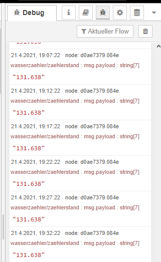

Hi, @Busmeikel
Can you publish your flow or a screenshot of what you see in your "Debug" window?

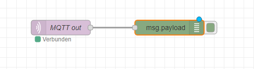

Hi FireWizard,
my "Debug" looks like that
It is the value in m³, published every 5 minutes. It would be fine to have that counter in Domoticz and also a function maybe "Liter per day" or something like that.

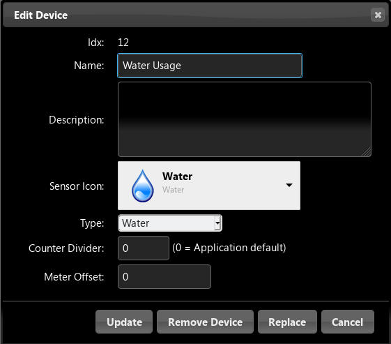

3. Go to the device under the "Utility" tab.
Edit the device as follows:
Make a note of the Idx:. In this case it is 12.

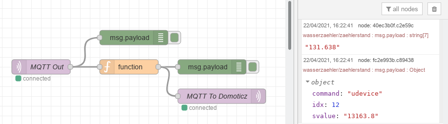

The flow looks as follows:
The Function node "translates" the received input to the required Domoticz input.
The contents is as follows:
Brief explanation:
As you have seen above the Water sensor receives its value in the svalue variable.
But we have to calculate with the value.
1. The first function (parseFloat) converts the string ("131,638") to a Number.
2. This number is multiplied with 100
3. The result is formatted to 1 digit after the comma (toFixed(1))
4. This value is sent to Domoticz
See the "debug" part in the picture.

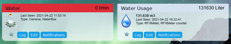

If everything is correct, you will see:
You asked:
If you have available a flow meting, you can also use the other sensor (Currently Red, as it receives no data)
msg.payload = {"command":"udevice", "idx":12, "svalue":(parseFloat(msg.payload) * 100).toFixed(1)}
return msg;

The Liter per day, you will find in the Log files of the Sensor.It is the value in m³, published every 5 minutes. It would be fine to have that counter in Domoticz and also a function maybe "Liter per day" or something like that.

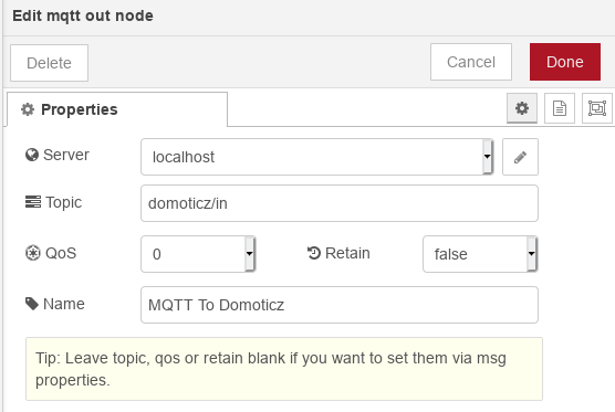

You said:
The topic should be changed to the topic that Domoticz has subscribed to.
So that means that you have to publish to the same topic as you configured in Domoticz.
If you left the fields empty, you have to publish to domoticz/in.
So try it and let´s hope we have more success now.

Yes, I can imagine that it is a loop, because you publish the same value to the same topic as you did subscribe to.@FireWizard: Can you help with "MQTT To Domoticz"
You said:
Your topic is "wasserzaehler/zaehlerstand ". If you publish the final value to that same topic, it will go into a loop.It is not clear for me how to configure the "MQTT To Domoticz"-Node, when I put in the same topic of "MQTT Out"
it lasts in a closed loop and I have to delete the node and restart Node red.
