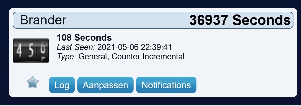

Can someone give me some help, I have an old central heater and hooked up an sensor to the burner, now I can monitor the time this is powered/on and with the som of how much gas it uses per hour i can make the calculations.
I'm aiming for an counter that counts the time the burner is on and as I have an number of how much it uses per hour/minute an extra counter that counts gas in M³
I already found some dummies where I can make the sensor but I have no clue how to create a script for this any help is appreciated.

Looks ok but aint working, thanks for the tip, getting little closer

Thanks a lot, works just fine! Now search for a way to convert this to an gas volume...waltervl wrote: Wednesday 05 May 2021 22:16 In DzVents you can start with this

Change linejacobsentertainment wrote: Wednesday 05 May 2021 23:33Thanks a lot, works just fine! Now search for a way to convert this to an gas volume...waltervl wrote: Wednesday 05 May 2021 22:16 In DzVents you can start with this
viewtopic.php?p=274121#p274121
iCounter.updateCounter(secondsActive)
To
iCounter.updateCounter(secondsActive*conversionfactor)
And change the virtual custom device from time to gas with units m3 (or whatever you want to use)

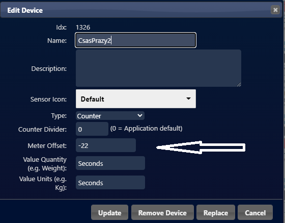

One last question, is there a way to reset the counter to 0 or an specific number?

Only by editing the data in the database using sqlite or similar tool.jacobsentertainment wrote: Thursday 06 May 2021 22:15 One last question, is there a way to reset the counter to 0 or an specific number?

Sorry I was under the impression that you used a gas device type. For a counter you could try using the offset in the edit popup from the utility tab.jacobsentertainment wrote: Thursday 06 May 2021 22:26Ok thanks for the reply!waaren wrote: Thursday 06 May 2021 22:22 Only by editing the data in the database using sqlite or similar tool.

That works partly
I think the hard way is the best way to set it to 0. delete the counter, create a new one and adjust the idx number in the script. It's a rough one but works
