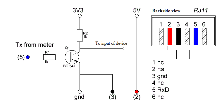

this may be a cheap chinese knockoff, and not a true FTDI.
if that is the case, you can invert like this.

Thanks,
Where would I get the 3.3 from as the FTDI is set to 5V?
Assuming I can get GND from the FTDI, also I have put a 10K between 5v and RDX already.
Would a BC547C do?
Hemant
Would a BC547C do?
Hemant

Re: P1 with FTDI not saving inversion
a bc547c is fine.
if your ftdi is 5v tolerant on rx you can feed the bc547 with 5v.

Hi Thanks rob,
just to check:

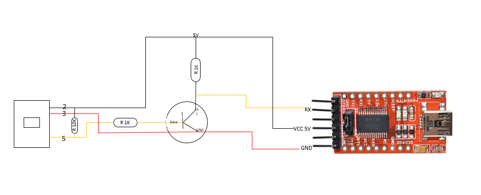

Q1 before 1k goes to RDX and Q1 after 1K goes to 5V split from FDTI
just to check:
not quite sure what you mean here
blue dot (5) connects with rj12 pin 5 of connector to meter
white dot to input of device connects with rx of ftdi adapter.

- Posts: 101
- Joined: Monday 05 November 2018 17:41
yes correct and the 3.3v in my case connect to 5v on fdti.
Also would the 10k pullup still be required betwen vcc and RX?
- Posts: 101
Mine is like in the attachment.
Any advice?
Any advice?
- Capture.PNG (119.9 KiB) Viewed 2613 times
looks good to me.
you can connect this and use a pc with a terminal emulator (win:putty or *nix:cu) to see if telegrams are sent by the p1 meter.

- Posts: 101
Thanks for all the help all is working and data is pulled into domoticz with this setup.
