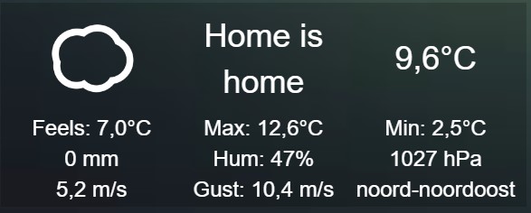

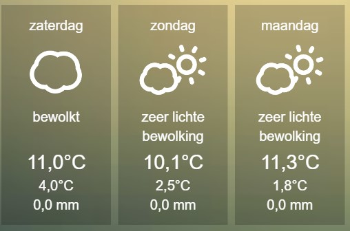

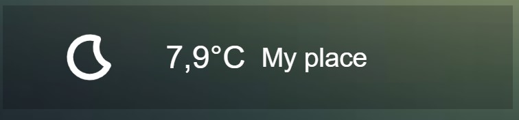

To improve the configurability of the weather block I decided to rewrite the weather block.
The old weather blocks are not supported anymore.
This means you have to update your weather block definitions!!
See the documentation: https://dashticz.readthedocs.io/en/beta ... tomweather
I've removed support for WeatherUnderground API, since no free API keys are provided anymore.
Only OpenWeatherMap is supported.
Currently four different layouts have been implemented:
The fourth one is an hourly forecast,
Depending on your feedback I may add a few more layout options, or update the existing ones.
There are some configuration parameters per block already. These will be extended as well.
