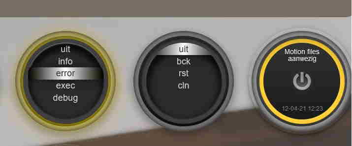

Is there a place where we can request functionality?
When my devices are on, they are yellow.
With on/off dials this is possible too, but with selector-devices i cant fix it...

You can do this with some customization tricks.pvklink wrote: Sunday 11 April 2021 13:14 Got it, and working great!
First add the right device status via the device hook in custom.js :
function deviceHook(device) {
if (device.idx==9) {
var level=parseInt(device.Level);
device.deviceStatus='level'+level
As a next step, add the styling to custom.css:
/*ring color*/
.level10 .dial-center {
box-shadow: 0 0 25px 1px green !important;
/*selected item color*/
.level10 .status {
--dial-color: green !important
/*ring color*/
.level20 .dial-center {
box-shadow: 0 0 25px 1px red !important;
.level20 .status {
--dial-color: red !important
If the selector switch has level20, the ring color as well as the selector text will turn red.

Could not wait, so during lunch
It works !
Only a small thing with the colors, i use in both cases( switch and selector) value gold.
But they look different:
- one changes the color on the second ring(on/off) and the selector the first ring
- the color gold is interpreted different for both, i tried opacity with the selector switch but that did not work...
Script: one if-statement to check all selectors
if (device.idx==2269)
var rpiactive = device.Data;
device.deviceStatus = rpiactive=='Geen melding' ? 'good':'bad';
if (!(device.idx in [,2253,2197,2254,etc])){
It works !
