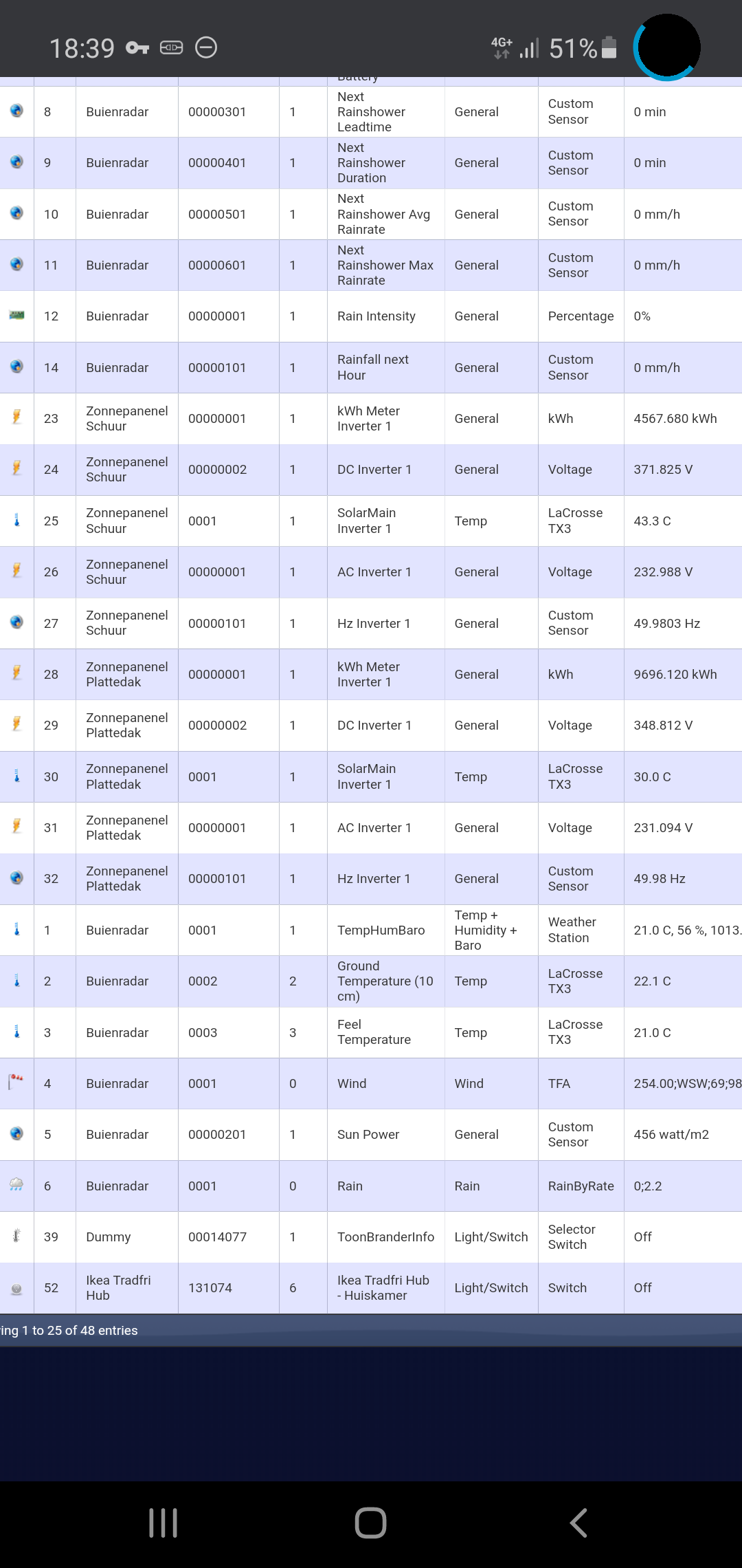

In the past 2 days Domoticz is not showing the kWh anymore.
Anyone else getting this result?
Odroid N2+ 4GB, Finally updated to 2025.2, with an RfxTrx433E, Zigbee2MQTT with Slaesh's CC2652RB, Zwave-JS-UI, SolarEdge, iRobot and P1 connected.

Did you update Domoticz and cleared your browser cache? https://www.domoticz.com/wiki/Browser_Cache
