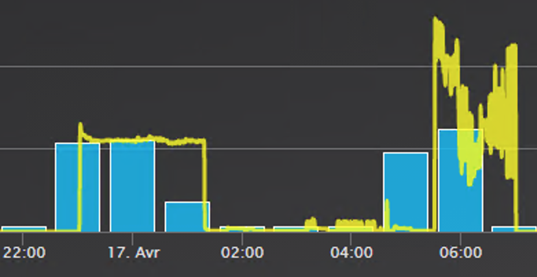

Hello everyone,
I'm a beginner on Domoticz ... I use it with a Shelly EM connected via MQTT to monitor my power consumption.
I have a quick question about the representation of the KWH graph (type 243, subtype 29).
On the graph, the histogram representing the KWh is shifted by half an hour compared to the instantaneous data ??? (see attachement)
According to my understanding, this histogram is visually timed to the time (for example 11 p.m.) and it looks like the calculation is made on the data from 10:30 p.m. to 11:30 p.m. - but no, obviously, it's rather calculated on data from 11 p.m. to midnight.
How can I set the bars of the histogram from 11 p.m. to midnight?
It's just a visualization problem.
Thank you

Re: KWH graph (type 243, subtype 29)
Do you run stable 2020.2 or a beta?
I run a beta and do not have this behavior on my Kwh graphs but I am not sure I have exactly the same device type 243 s 19.
The graphs have been updated in beta. I do not think there is an option now to modify this behavior in stable so you will have to wait for next stable.

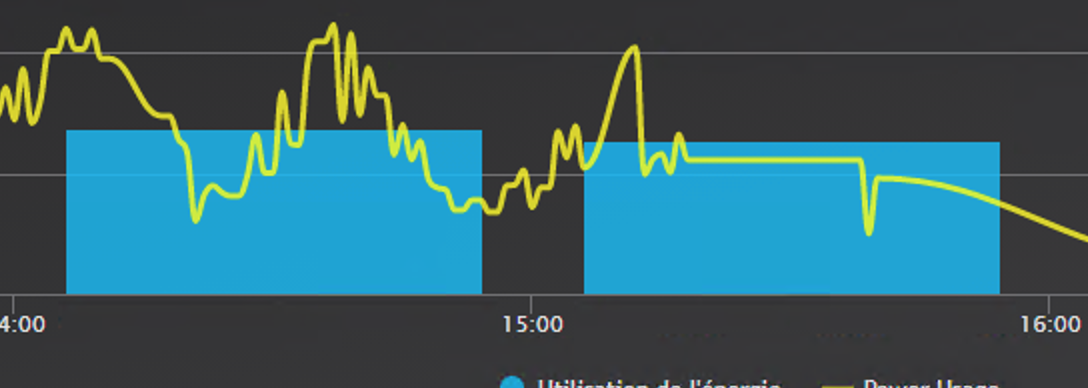

Thanks waltervl
I just tried the beta version and yes it's better now: o))
when will the stable version be released ???

Sellig
Posts: 6
Joined: Saturday 17 April 2021 9:41
Post by Sellig »
GREAT !
I'm asking a question...
I get a quick response to try a beta version!
It works !
and ... hop, the final version arrives ;o))
Well done for this responsiveness!
thanks waltervl
