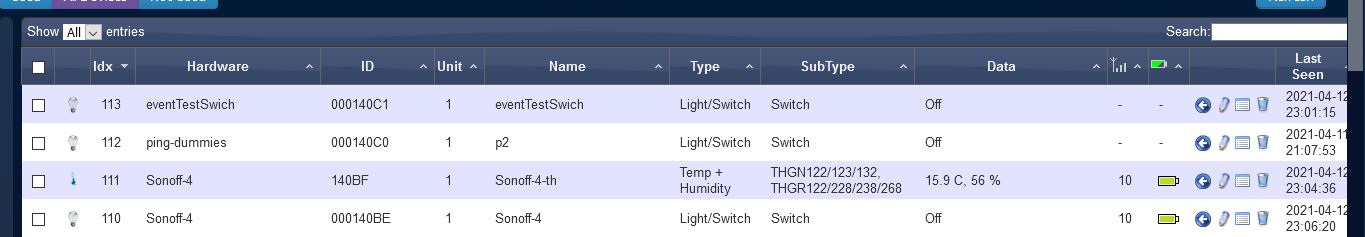

Can you share a screenshot of your devices tab?

Are device 103 and 100 set to active? (Are the arrows on devices tab blue?)
Yes they are blue
As mentioned earlier, typos on the idx, should have been 113 and 110, scripts are fine.
Both are blue, only 110 appears in the log (due to wildcard)

Re: Cannot get dzVents to trigger
Sjoko wrote: Wednesday 14 April 2021 22:22
http://pi:8080/json.htm?type=devices&rid=113
http://pi:8080/json.htm?type=hardware
Sjoko wrote: Saturday 17 April 2021 21:12 I peeked in the file, but dunno what to look for.
Hope this helps
All looks normal. No clue why an update to device 113 does not trigger the script. II tested the exact setup on 2020.2 but cannot replicate the issue. It might be worthwhile the create another virtual switch with a different name or to upgrade to 2021.1
