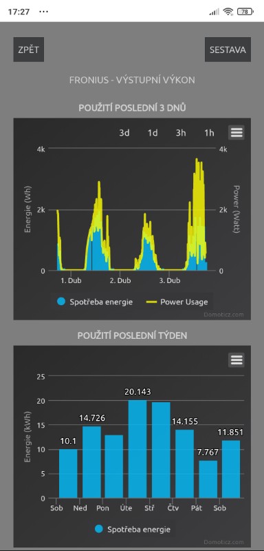

Re: Fronius solar daily counter large negative value
Post by tomyc »
I had same problem like you. I changed daily energy read from "from device" to "computed". The difference between Inverter and Domoticz in daily use is minimal.
