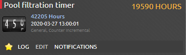

First and foremost, I would like to thank the contributors for this script that has proven to be quite useful.
However, since I last updated Domoticz (the latest march version), my counter has gone haywire. It used to count correctly, an hour here and there of daily use, and a correct total increment (around 300 since I included the script).
Since the Domoticz update (on my Syno NAS), the total counter shot up to 21000, and yesterday's daily counter was up to 19000. Tried to work out numbers, wondering if it was an hours/minutes/seconds problem, but the numbers don't seem to add up.
Anyone else encountering issues since the update?
Re: Updating incremental counter with TIME value / json
Ayep wrote: Friday 27 March 2020 8:22 Since the Domoticz update (on my Syno NAS), the total counter shot up to 21000, and yesterday's daily counter was up to 19000. Tried to work out numbers, wondering if it was an hours/minutes/seconds problem, but the numbers don't seem to add up.
can you please set the script log to debug and share your devicetype(s) and other settings ? Maybe it helps in finding what is causing the issue.

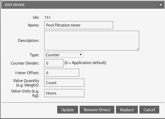

Ayep
Posts: 15
Joined: Friday 27 March 2020 8:16
Domoticz version: 2023.1
Location: France
Post by Ayep »
OK thanks, here we go.
The timer is used to work out the duration of the pool filtration (another script, totally independent at this time, sets filtration at specific times and duration according to temperature - no variable is passed to and from though).
I've done a manual calculation, every minute now increments 344 hours on the counter. (Why 344? Can't find any obvious link - it's divisible by 8, which gives 43, a prime number)

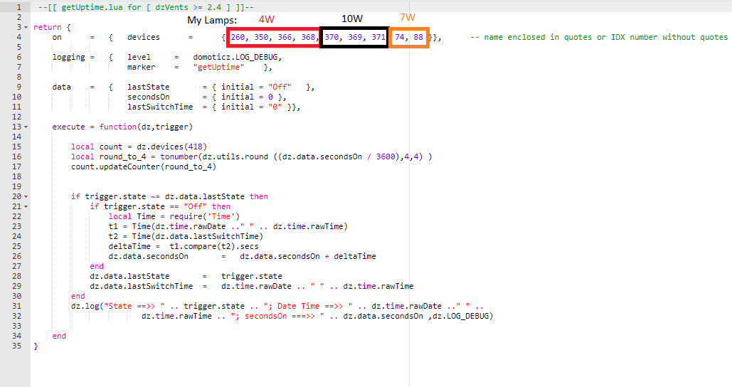

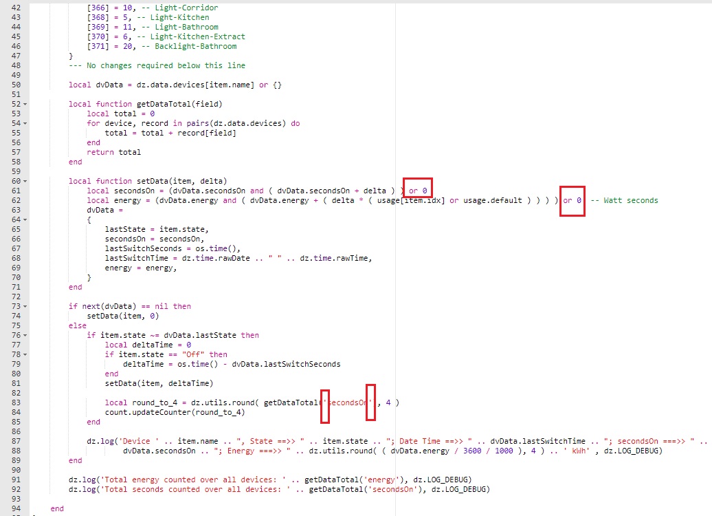

Dear @waaren,
I have also started using this script to monitor heating minutes daily. I see that the script adds up the total number of minutes the heater is on. I would like to be able to reset this counter 2 times a day for example at 09:00 am and at 21:00 pm and that before resetting the counter receive a telegram with the minutes that the boiler has consumed in the morning and the minutes that the boiler has consumed boiler at night.
no matter how much I think about it, I can't implement this. To reset the counter, I think it would be enough to enter "dz.data.secondsOn = 0", but I can't enter it in the script.

Good afternoon, with the help of your code I have set up a Counter for myself, which counts the total working time of light bulbs in the house. Tell me, is it possible to somehow calculate the total energy consumption, and take into account in the code that each light bulb has a different consumption in W?
19leva89 wrote: Thursday 01 April 2021 11:32 Good afternoon, with the help of your code I have set up a Counter for myself, which counts the total working time of light bulbs in the house. Tell me, is it possible to somehow calculate the total energy consumption, and take into account in the code that each light bulb has a different consumption in W?
Yes that's possible.
Please share your script between code tags </> or if you cannot find these as plain text. That will help me showing you how it can be done.
19leva89
Posts: 12
Joined: Tuesday 28 July 2020 8:46
Domoticz version: 2020.2.1
Post by 19leva89 »
 --[[ getUptime.lua for [ dzVents >= 2.4 ] ]]--
    on      =   {   devices      =      { 260, 350, 366, 368, 370, 369, 371, 74, 88 }},      -- name enclosed in quotes or IDX number without quotes
    logging =   {   level     =   domoticz.LOG_DEBUG,
                    marker    =   "getUptime"    },
    data    =   {   lastState       = { initial = "Off"   },
                    secondsOn       = { initial = 0 },
                    lastSwitchTime  = { initial = "0" }},
    execute = function(dz,trigger)
        local count = dz.devices(418)
        local round_to_4 = tonumber(dz.utils.round ((dz.data.secondsOn / 3600),4,4) )
        count.updateCounter(round_to_4)
        if trigger.state ~= dz.data.lastState then
            if trigger.state == "Off" then
                local Time = require('Time')
                t1 = Time(dz.time.rawDate .." " .. dz.time.rawTime)
                t2 = Time(dz.data.lastSwitchTime)
                deltaTime =  t1.compare(t2).secs
                dz.data.secondsOn       =   dz.data.secondsOn + deltaTime
            dz.data.lastState       =   trigger.state
            dz.data.lastSwitchTime  =   dz.time.rawDate .. " " .. dz.time.rawTime
        dz.log("State ==>> " .. trigger.state .. "; Date Time ==>> " .. dz.time.rawDate .." " ..
                       dz.time.rawTime .. "; secondsOn ===>> " .. dz.data.secondsOn ,dz.LOG_DEBUG)

Good evening, thanks for the script! He's almost working, he doesn't want to count the seconds.
2021-04-01 20:14:15.921 Status: User: Admin initiated a switch command (368/Light-Kitchen/On)
2021-04-01 20:14:16.164 Status: dzVents: Info: Handling events for: "Light-Kitchen", value: "On"
2021-04-01 20:14:16.164 Status: dzVents: Info: getUptime: ------ Start internal script: Light-kWh: Device: "Light-Kitchen (Dummy-Sensors)", Index: 368
2021-04-01 20:14:16.166 Status: dzVents: Debug: getUptime: Processing device-adapter for test-power: Counter device adapter
2021-04-01 20:14:16.166 Status: dzVents: Debug: getUptime: Total energy counted over all devices: 0
2021-04-01 20:14:16.166 Status: dzVents: Debug: getUptime: Total seconds counted over all devices: 0
2021-04-01 20:14:16.167 Status: dzVents: Info: getUptime: ------ Finished Light-kWh
2021-04-01 20:14:37.146 Status: User: Admin initiated a switch command (368/Light-Kitchen/Off)
2021-04-01 20:14:37.278 Status: dzVents: Info: Handling events for: "Light-Kitchen", value: "Off"
2021-04-01 20:14:37.278 Status: dzVents: Info: getUptime: ------ Start internal script: Light-kWh: Device: "Light-Kitchen (Dummy-Sensors)", Index: 368
2021-04-01 20:14:37.280 Status: dzVents: Debug: getUptime: Processing device-adapter for test-power: Counter device adapter
2021-04-01 20:14:37.280 Status: dzVents: Debug: getUptime: Total energy counted over all devices: 0
2021-04-01 20:14:37.280 Status: dzVents: Debug: getUptime: Total seconds counted over all devices: 0
2021-04-01 20:14:37.281 Status: dzVents: Info: getUptime: ------ Finished Light-kWh
I am just starting to understand the language of DzVents, is there something in the code in these highlighted places?
19leva89 wrote: Thursday 01 April 2021 19:33 Good evening, thanks for the script! He's almost working, he doesn't want to count the seconds.
Just let it execute for a couple of switches. The first switch will be 0. Only when a device is switched off after a first switch On since the script was active the counter will increase.
the 'or 0' is there to ensure the value will be initialized the first time when the entry is still nil. This is standard Lua coding practice. Not dzVents specific.
The quotes around secondsOn are required because it is a string. Without the quotes it would be a variable.

Today I tried to turn on and off different switches several times, the seconds are still at zero
19leva89 wrote: Friday 02 April 2021 8:10 Today I tried to turn on and off different switches several times, the seconds are still at zero
Tested on my system and works as expected and without issues
Can you share the script as you have it now between </> tags? Then I will add some debug lines to help finding where the differences between our setups are.
