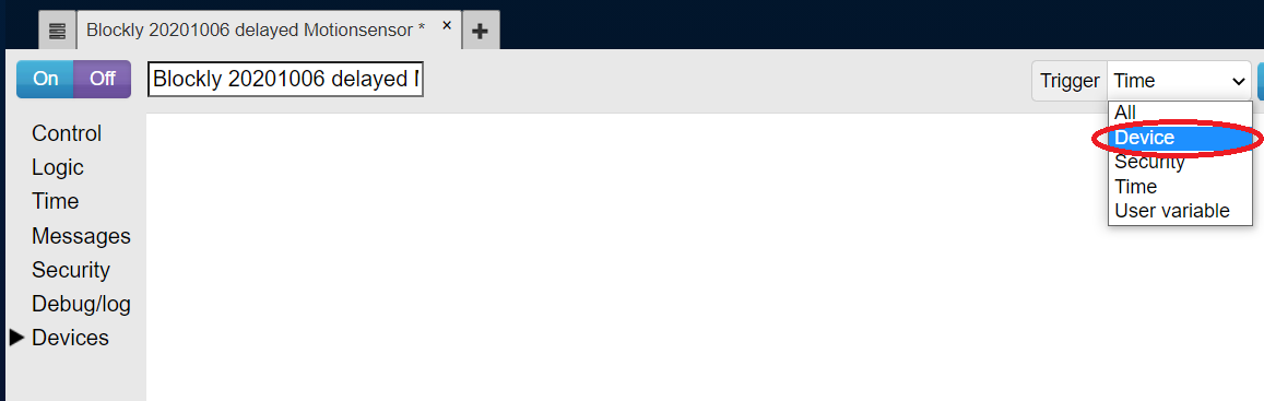

If you saved your Blockly as time triggered you might want to try again after saving as device triggered.
Blockly trigger.png (38.64 KiB) Viewed 783 times

it is on all, I have now changed it. see what happens. I'll keep you informed
