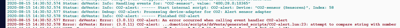

I tried the script you sent. The log shows:
CO2 alert.png (21.41 KiB) Viewed 2878 times
This output was confusing to me but also provides a lot more clarity.
The hardware sensor is an ESPeasy with a MH-Z19. The MH-Z19 sends the CO2 value, the temperature and an U value. The Domoticz custom sensor only shows the ppm value. I only took the CO2 value into account. So first find out the output in a next script. I understand where the error message comes from.
I think the output of the sensor should be split. I've read that the stringSplit (string, [separator]) can be used for this, but I don't know how.

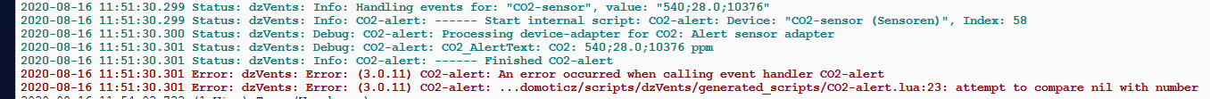

After the adjustment, the log shows:
CO2 alert.png (23.1 KiB) Viewed 2846 times
Jan

 2020-08-16 15:19:37.182 Status: EventSystem: Script event triggered: /home/pi/domoticz/dzVents/runtime/dzVents.lua
2020-08-16 15:20:19.068 Status: dzVents: Info: Handling events for: "CO2-sensor", value: "911;29.0;10376"
2020-08-16 15:20:19.068 Status: dzVents: Info: CO2-alert: ------ Start internal script: CO2-alert: Device: "CO2-sensor (Sensoren)", Index: 58
2020-08-16 15:20:19.070 Status: dzVents: Debug: CO2-alert: Processing device-adapter for CO2: Alert sensor adapter
2020-08-16 15:20:19.070 Status: dzVents: Debug: CO2-alert: CO2_AlertText: CO2: 911;29.0;10376 ppm
2020-08-16 15:20:19.070 Status: dzVents: Info: CO2-alert: ------ Finished CO2-alert
2020-08-16 15:20:19.070 Error: dzVents: Error: (3.0.11) CO2-alert: An error occurred when calling event handler CO2-alert
2020-08-16 15:20:19.070 Error: dzVents: Error: (3.0.11) CO2-alert: ...domoticz/scripts/dzVents/generated_scripts/CO2-alert.lua:23: attempt to compare nil with number

Jan Jansen wrote: Sunday 16 August 2020 15:26
It seems that your custom sensor also receives two other datapoints; temperature and barometer?
The rawData table contains all separate values of the sValue atrribute
Can you try this?
