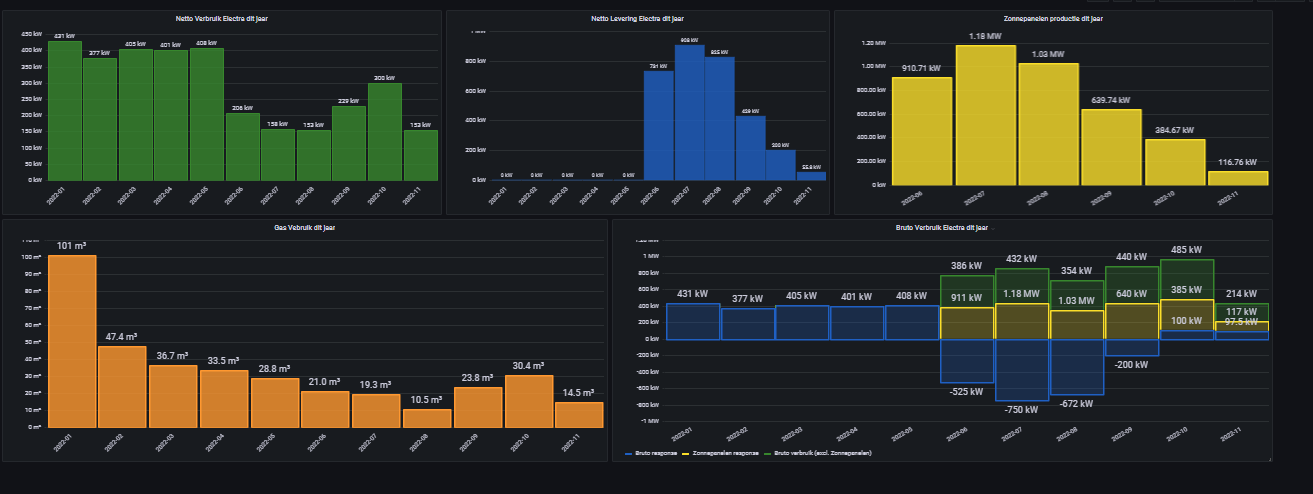

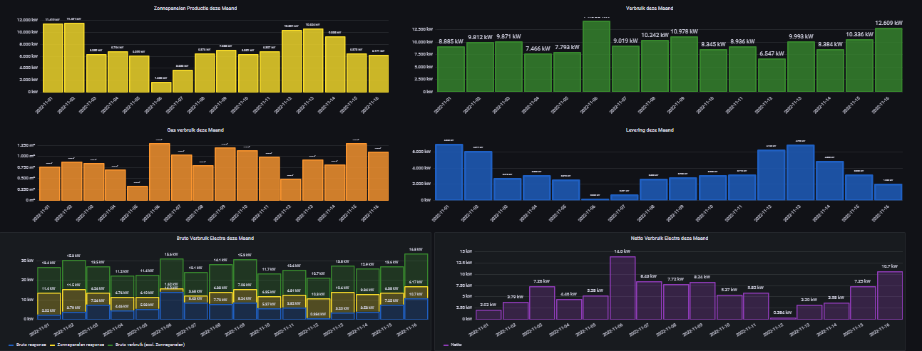

Finally after some struggeling to get the Database History in grafana I'm not also using the SQL Lit plugin. Initially I had some issues with getting erros after refresing the dashboard "Database malformed 11". Even when the database was in readonly mode, so solve this i'm making a daily copy (realtime data is commingg in using influx for daily stats). I have a Synology job which runs every night so i have Today-1 which is more than enough for Monthly and Yearly statistics. I could use Grafana for this but but had 2 problems 1. Missing Historicat data and 2. FluxQL is not month away so the graphs look strange.
I'm a beginner when it comes to writing SQL, not my core competence, however i mages to create a Monthly and a Yearly totals dashboard directly using the SQL plugin and using Meter_calendar and MultiMeter_calendar.
Results Attached.
If people are interested in the queries, let me know, happy to share them. Also if someone has a bright idea on how to do the Bruto Verbruik, in a smarter way please share, currently did a transform in Grafana with a nasty outerjoin, should be a smarter way.
Cheers,
Hemant
