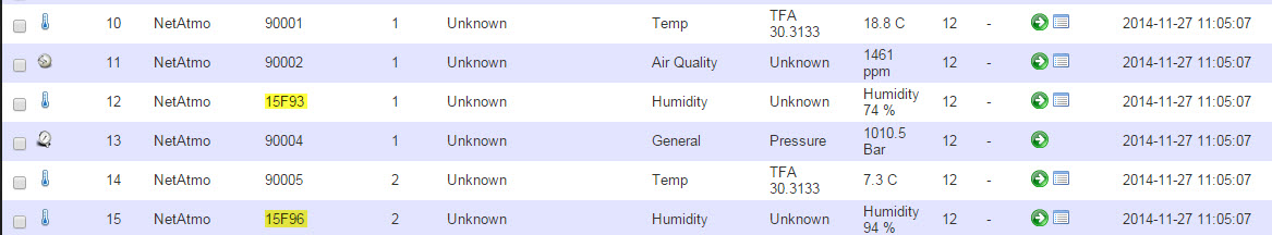

Is it possible by script to change the name of "Unknown" to "Netatmo"like in image?
COOO it is created by virtual hardware and then Air quality.
I'm afraid that is not possible without changing domoticz itself, not sure though, I'll have a look through the C++ code.

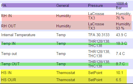

I did it but Hum_out it is taken Humidity 96 % so will be an error
What are the jq comands or another command to take from the string "Humidity 96% the value 96....????
Same for Pa 1008.3 Pa and I need 1008.3 ????
If ai put these values manualy all are ok, the virtual sensor SetPoint are update
12-12-2014 16-53-46.jpg (63.42 KiB) Viewed 11824 times
#!/bin/bash
# Take the data from Domoticz
Temp_out=`curl "http://127.0.0.1:8080/json.htm?type=devices&rid=8" 2>/dev/null | jq -r .result[]."Temp"`
Temp_int=`curl "http://127.0.0.1:8080/json.htm?type=devices&rid=9" 2>/dev/null | jq -r .result[]."Temp"`
Hum_out=`curl "http://127.0.0.1:8080/json.htm?type=devices&rid=7" 2>/dev/null | jq -r .result[]."Data"`
Hum_int=`curl "http://127.0.0.1:8080/json.htm?type=devices&rid=10" 2>/dev/null | jq -r .result[]."Data"`
Pa=`curl "http://127.0.0.1:8080/json.htm?type=devices&rid=11" 2>/dev/null | jq -r .result[]."Data"`
#Calculation
#1. The calculation of Psat = EXP(23,3265-(3802,7/(Temp_C+273,18))-(472,68/(Temp_C+273,18))^2) [Pa]
#2. The absolute humidity HS=(0,622*Psat*HR)/(PA-Psat*HR)*1000 [geau/kg air sec]
#3. L'eau chambre volume [m3] * mass l'air [kg/m3] * HS[g/kg] = [g]
Psat_out=`echo "e(23.3265-(3802.7/($Temp_out+273.18))-(472.68/($Temp_out+273.18))^2)" | bc -l`
HS_out=`echo "(0.622*$Psat_out*$Hum_out/100)/($Pa*100-$Psat_out*$Hum_out/100)*1000" | bc -l`
Psat_int=`echo "e(23.3265-(3802.7/($Temp_int+273.18))-(472.68/($Temp_int+273.18))^2)" | bc -l`
HS_int=`echo "(0.622*$Psat_int*$Hum_int/100)/($Pa*100-$Psat_int*$Hum_int/100)*1000" | bc -l`
#Add the calcutation to virtual sensor
A1=`curl "http://127.0.0.1:8080/json.htm?type=command&param=udevice&idx=21&nvalue=0&svalue=$HS_out"`
A1=`curl "http://127.0.0.1:8080/json.htm?type=command&param=udevice&idx=24&nvalue=0&svalue=$HS_int"`
