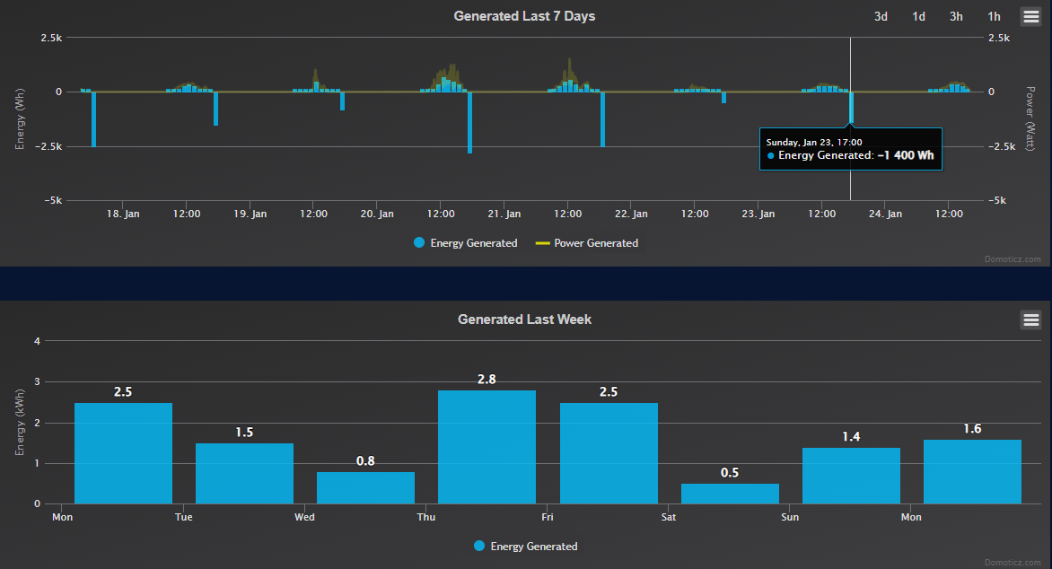

I have a strange issue - wonder what I'm doing wrong: at the end of every day it shows a large negative bar - that is exactly what has been produced that day. Sort of like a reset. Do you know what I'm doing wrong? Thanks!
syrhus
- Posts: 79
- Joined: Tuesday 12 December 2017 14:10
- Domoticz version: 2021.1
- Location: Paris
Re: Python plugin - Solax Inverters
Hi jldjong
I had the same issue with the last version of Domoticz.
I had to switch the Energy read property from Device to Computed. On previous version, I didn't have any problem.
This bug appears from 2021.1

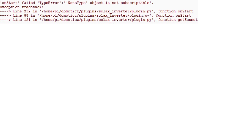

i'm trying to get Solax inverter working in domoticz.
Getting an errors. Does anyone knows how to solve it?
This is working in the browser
http://192.168..........;8080/json.htm?type=command¶m=getSunRiseSet
- domsolax.jpg (41.58 KiB) Viewed 1450 times
syrhus
- Posts: 79
- Location: Paris
Hi dospider
Could you please switch the debug parameter to true to get the entire log please?

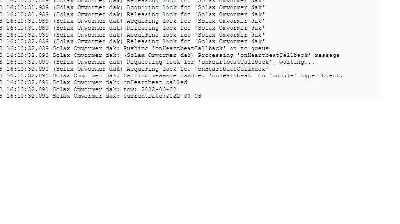

dospider
- Posts: 15
- Joined: Monday 04 August 2014 18:43
Thnks for the very quick respons. See attachment. That's all i see.
- solaxdebug.jpg (108.3 KiB) Viewed 1448 times

- Posts: 79
- Location: Paris
I don't see the error
Did you enter in the plugin parameters your domoticz' IP address and port => 192.168.x?.x? and port 8080 in your case?
