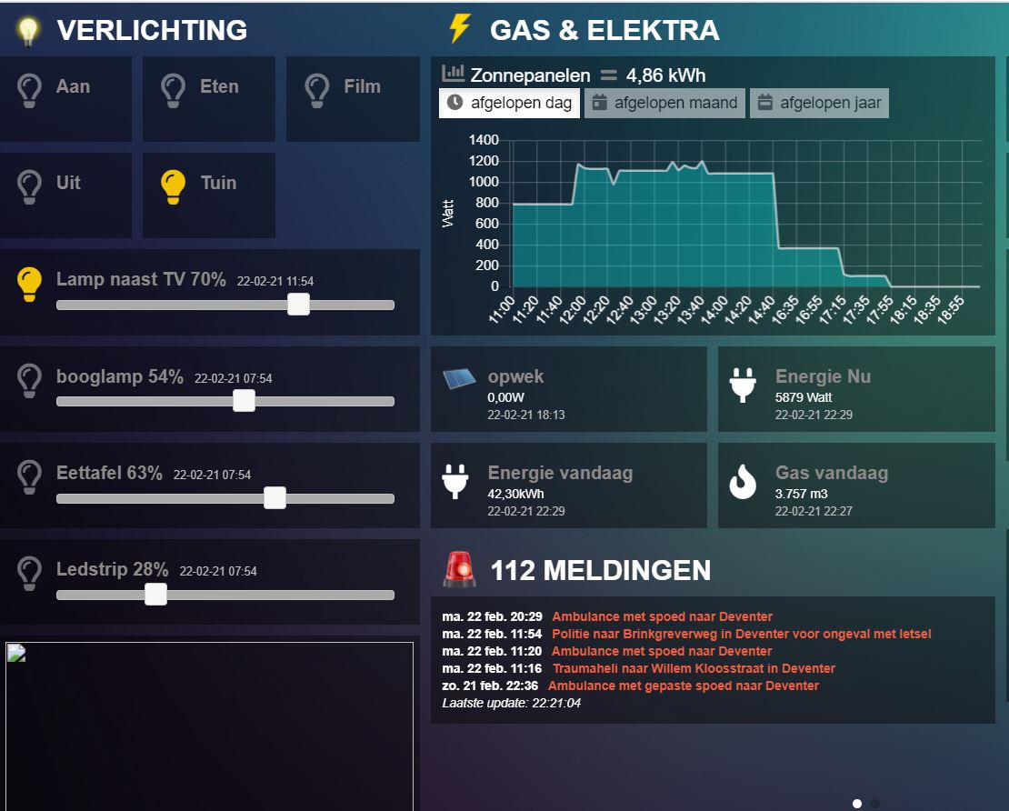

i bought a Dahua IP camera and am trying to get a view in dashticz.
I have found the camera in Domoticz.
but if i use the next code in dashticz it only gives me the picture view which refreshes once per seconde?
(and this picture refresh sometimes does not run smoothly)
and not the movie stream? what is the video stream in domoticz? can't find that anywhere?!
blocks['cam1'] = {
 type: 'camera',
 imageUrl: 'http://192.168.2.11:8084/camsnapshot.jpg?idx=1',
 videoUrl: 'http://192.168.2.11:8084/camsnapshot.jpg?idx=1',
 refresh: 1,
 width: 12,
 height: 300
i also found the http adres of the camera, is it possible tot use that snapshot en video URL in Dashticz?
i tested both URL's in my browser and they work! But they don't work in Dashticz???
blocks['cam1'] = {
      type: 'camera',
      imageUrl: 'http://192.168.2.200/cgi-bin/snapshot.cgi?1&user=[USERNAME]&pwd=[PASSWORD]',
      videoUrl: 'http://192.168.2.200/cgi-bin/mjpg/video.cgi?channel=1&subtype=1&user=[USERNAME]&pwd=[PASSWORD]',
      refresh: 1,
      width: 12,
      height: 300
domotics camera.JPG (48.12 KiB) Viewed 3788 times

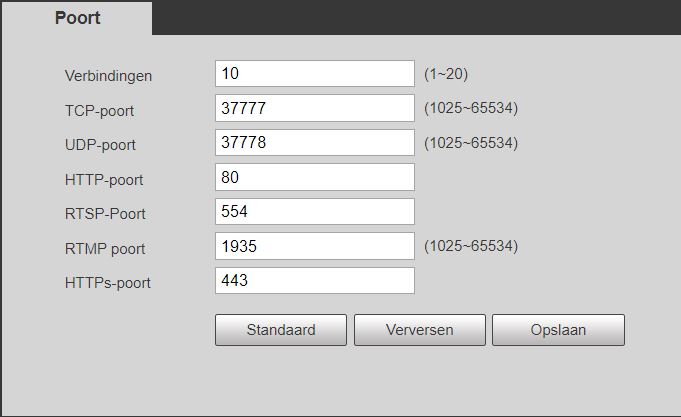

The port number should match the port number configured in your camera.

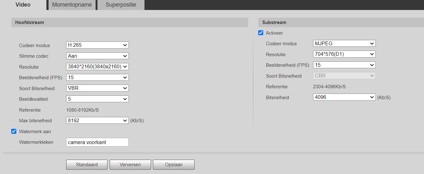

* In my case port number 80 is the http port, do you use the HTTP port for the stream in dashticz?
* Is it also possible to use the snapshot url from the dahua camera in dashticz?
* Do you use the main stream for playback in dashticz? my substream is only a 704x506 stream and higher is not possible.
The code above that i used (first post) gives problems in dashticz, for example : switshing on the lights give a delay of more than 5 a 10 seconds before they turn on or off after i touch the scene in dashticz... so there must be something wrong in mij config part of the IP camera. :?
(after //excluding the camera part in the config its fast again...)
camera instellingen.JPG (65.66 KiB) Viewed 3720 times

The streams are all from the substream of the camera itself, in my case it has enough detail for showing on the wallmounted tablet.
The setting in the camera for the substream are MJPEG 720P (1280*720), and 704*576(D1)
The port I use is port 8080, that's HTTP.
Maybe the camera type and/or software version makes some different for the quality of the substream, and configuration.
I have camera type: IPC-HDBW4431R-AS and IPC-HDBW4631R-ZS and IPC-HDW4631C-A

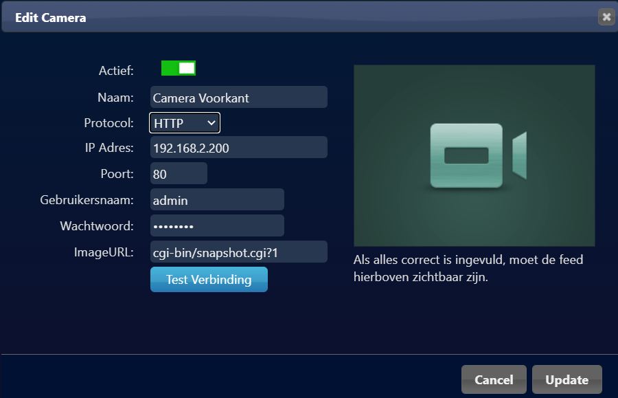

Can you send a print screen of your dahua camera settings in Domoticz?
2 weeks ago i had snapshot working in my Ds213, but because of the slow processor i upgraded it last weekend to a Ds220+ and lost the camera settings of the link for the snapshot. been trying a lot of different settings but can't get it working again :?
Chris12
Posts: 238
Joined: Tuesday 18 August 2020 8:41
Domoticz version: 2021.1
Re: Dahua IP camera view in Dashticz
Post by Chris12 »
In domoticz I have the following settings for all camera's:
-enabled: checked
-protocol: HTTP
-port: 8080
-ImageURL: cgi-bin/snapshot.cgi
"cgi-bin/snapshot.cgi?1" should also work (without the "")
Domoticz beta | Dashticz beta | Synology DS415+ | Wall tablet Teclast 11.6inch (Android) | TADO v3 controlled heating

THANKS for the snapshot URL in Domoticz
i now use the next snapshot URL and i get a picture
i need to use
forcerefresh=1
to force the picture stream not to freeze, only
refresh: 1
doesn't work...
