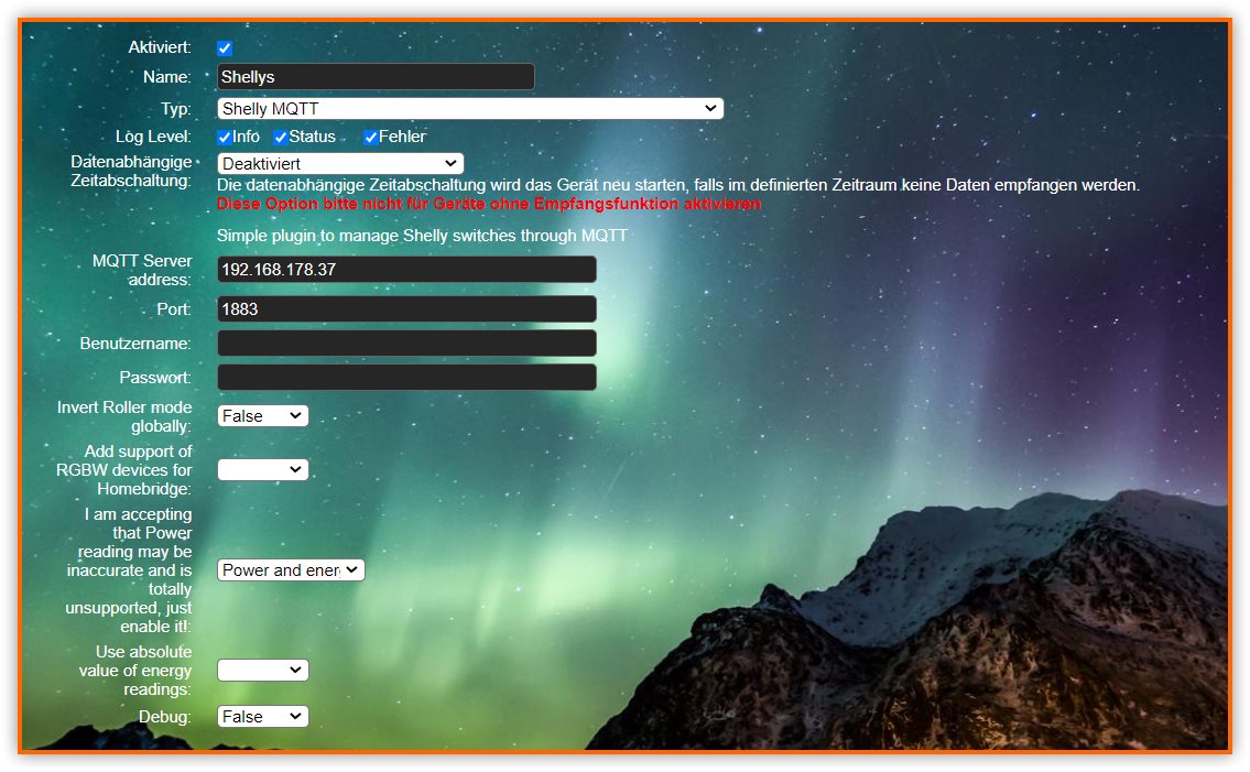

salopette
Posts: 187
Joined: Tuesday 07 March 2017 21:03
Location: Germany
Re: Python Plugin: Shelly MQTT
Post by salopette »
(Shelly) Failed to connect to: 192.168.1.53:1883, Description: Connection refused
2021-03-03 16:37:09.732 Error: (Shelly) Disconnected from MQTT Server: 192.168.1.53:1883
2021-03-03 16:29:05.584 Status: MQTT: Connecting to 127.0.0.1:1883
2021-03-03 16:29:05.785 Status: MQTT: connected to: 127.0.0.1:1883
2021-03-03 16:29:05.986 Status: MQTT: Subscribed
something is wrong with your mqtt settings!
What kind of address did you have on shelly?

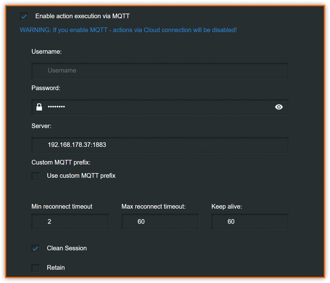

extremeaudio
Posts: 47
Joined: Tuesday 24 November 2020 17:57
Post by extremeaudio »
The shelly is at 192.168.1.56
My domoticz server is 192.168.1.53
So from the Shelly 1 PM settings, I have enabled MQTT, set the MQTT server settings to 192.168.1.53:1883
In MQTT Client Gateway with Lan Interface I have set the IP address to 127.0.0.1 since the gateway is installed on the domoticz server and port to 1883
In the Shelly MQTT plugin too I have the same IP address which is 127.0.0.1 and 1883
In the username section of the MQTT client the field came filled as "admin". This is because my domoticz is from the preconfigured image called smarticz, and the documentation doesnt say what username and password they have chosen, I just assumed. So I just chose a password and proceeded and saved the settings. I used the same username and password in the Shelly MQTT settings too. I am not sure if the username and password are correct, or how to check or rectify if wrong. Would appreciate any help. Thank you.
I dont mind if someone can guide me how to remove the MQTT gateway completely so that I can follow the standard procedure for re installing it with the correct username and password created along the way.
salopette
Posts: 187
Location: Germany
Post by salopette »
I don't think Shelly can do anything with local IP from Mqtt-Domoticz.
In Mqtt-Domoticz hardware configuration you should better enter the IP where the Mqtt broker is running. So 192.168.1.53.
And in the Shelly then also the IP 192.168.1.53

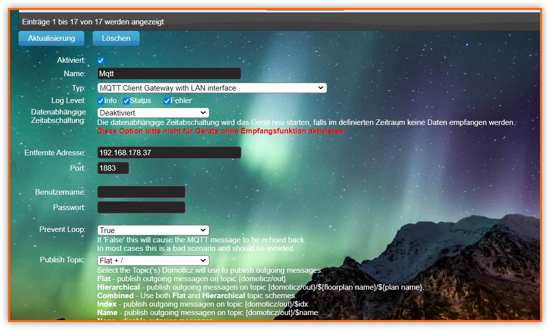

extremeaudio
Posts: 47
So you mean to say I should enter 192.168.1.53 (Domoticz server address) on the MQTT GATEWAY hardware page instead of 127.0.0.1 ? If I do that it says disconnected in the log if I remember correctly.
In shelly relay web interface I have already entered 192.168.1.53 obviously.
salopette
Posts: 187
Location: Germany
Post by salopette »
if the Mqtt server is running on the same machine as Domoticz, you should do that.
I have also made the setting for myself.

Posts: 187
Location: Germany
Post by salopette »
The Ip of Mqtt Broker has to be in there, i.e. that of the Domoticz if it is running on the same machine.

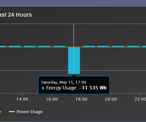

chal
Joined: Monday 02 October 2017 14:08
Post by chal »
First of all thank you for this great plugin.
Everything is working fine, but when i restart a shelly energy device i get a negative reading:
is there anything i can do?
Thank you!
